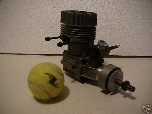

Hello,
I won a Supertiger 3000 in an auction with a plane. What I really wanted was the plane and I got it, but now I have a Supertiger 3000 with no home. Can this motor be converted to burn gas? I would never dream of running glow, but I want to run gas. I've never converted a motor though so I have NO idea about the in's and out's and even IF it can be done.

Here are a couple pictures of the motor that I have. I lifted these from the auction. I have the motor and it actually looks much cleaner and much less worn than in the pictures. One more question, IF it could/can be converted, would it put out enough power to carry around a 1/4 scale Patty Wagstaff Extra?
Thanks again,
BK

The oil/gas ratio in a Super Tiger has to be greater (more oil) than what you would run in a Zenoah or chainsaw engine.
This is because of the lack of needle bearings on the connecting rod. If the rod is modified for needle bearings, then the crank pin will wear out.
The Super Tiger carb as originally made will be almost impossible to set the mixture on when running gasoline.
With the extra oil needed with the engine conversion, A gallon of gas mix will cost you between $5 and $6.

I have two that were converted with needle bearing inserted in the stock rods and the crank pin turned down and a hardened race pressed on.... small walbro carb with machined aluminum adapter.... CH Ignition..... runs GREAT with an 18-8 on 50:1 gasil on an original (heavy) UltraStik 120....

By the time you add up the cost of a Walbro carb, the carb adapter, needle bearing conversion parts, and the ignition system, you will have enough investment to buy a "real" gasser.
If your question is whether it is possible to do a gas conversion, then yes.
If you're asking whether it is economically feasible, then no.
Also, CH ignition used to sell parts for needle bearing conversion for the Big Cats, but they say the stock rod is not hardened enough to take the needle bearings. Maybe some of the older Tigres have hardened crankshaft. FWIW, I have a newer Chinese-made G2300 and the crankshaft show signs of heat-treating, whereas my older (but still recent manuf) Italian-made G2300 does not.

what you end up with is a reasonably light 30cc gasser that has more power and weighs less than a G-38, for instance.... besides, it's fun !!!
the piston end of the rod is okay the way it is.... if you keep the revs where they belong, less than 8000, the stock rod will hold up fine....
as for the crank pin, again, I installed a hardened race.... and the Italian made crank was hardened, just not hard enough to take the needles... I had to hit it with a torch to anneal it enough to cut it on the lathe.... I think the Italian made engines were heat treated (properly) in an inert atmosphere, so no tell-tale discoloration....

How do you hold the crank shaft in the lathe?
Old 04-30-2005 | 05:56 AM
Joined: Mar 2005
Posts: 344
From: Treasure Island, FL
Default RE: Supertiger 3000 to Gas??
made a jig from a chunk of 4" AL bar stock.... bored a hole for the crank journal so the pin is on center.... dowel pins keep it from turning.... a friend does his on a milling machine...

Thanks I wonderd a bit about that. I have a moki 210 it has a hole down the center of the crank pin, which means it is to weak to turn down an press on a race like you did, I thought maybe I could turn it down a little and TIG weld some hard filler rod on then grind it to size, what do you think?

From: Riverton, WY
The Moki crank pin will break if you put a sleve on it and run it . You have to cut off the rod pin and then drill the crank and press in a solid hardened pin..... Several chances to ruin a good Moki crank.
