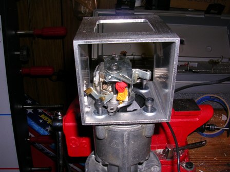

I was determined to do my conversion by myself. So, I mounted the flywheel in a work bench type drill press(with a drill). Put a bolt through the flywheel and glued sandpaper to a piece of wood and monted that on the bottom of the press. Chucked it in the drill and started sanding away. Not the fastest way to do it but it worked. I did not balance it and still have yet to fire it up on the test stand. So hopfully it is not way out of balance.
Here is a pic.

It looks like you have still got the ignition kill switch attached, I have heard these can cause radio problems, not sure if it is true. I just noticed and thought I might point it out. Otherwise nice neat conversion.

I have a 20A toggle switch that I was going to use. Is that the way to go?
Bill
BTW - It's a Wacker mount - here is another pic

I also removed the red and yellow plastic covers on the carb screws.

I am not sure, it's just what I have heard. I am using a ch cdi ignition so the ignition is killed by switching off the power. Sorry I cant be more help but some of the guys who have been doing this for a while should be able to say for sure. I will see if I can find where it was where i read that maybe there will be an explanation.
