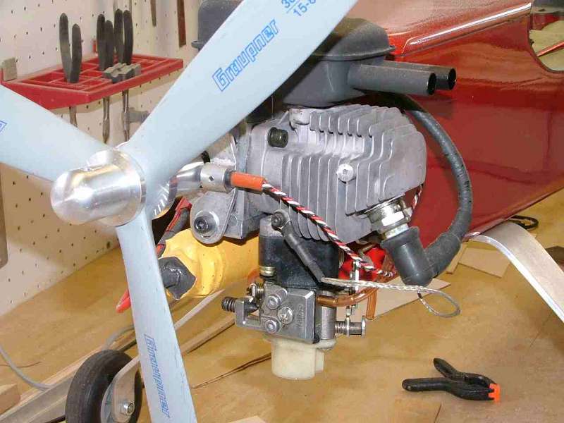

I have a Tanaka weedwhacker engine and it is manufactured by Robin. The one I have is 24.5cc and has two piston rings. Very good compression. I have converted two of the single ring Robin 24.5cc engine and they run great with C H ignition. I remove the mag and flywheel and use a Zenoah g23/26 prop hub (bolts right on) and a Zenoah Muffler. I also put a Walbro WT391 carb to improve the performance. I get 7200 rpm on a 16x8 Zinger prop.

My original plans were to convert a pair of them (done) and put them on my 96" Palmer OV10 Bronco. That was before the weight went from an estimated 30 pounds to a definite 40 pounds. I'm now looking for something in the 30-32 cc range. I built an enlarged Stik to test the engines on and like it so much I will keep the engines and fly the thing for everyday fun.

thats a very nice model, i liked the side position of the engine, on that position the spark never wet.
