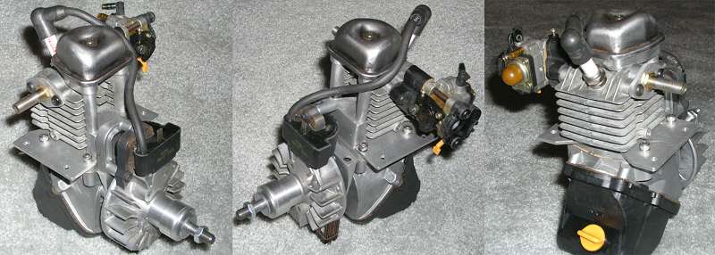

Got my harbor freight 26cc ryobi 4 stroker a while back, and finally had some time to begin fooling with it.
I stripped the heat shield stuff, the muffler, the flywheel and the ignition bracket and igntion save the spark plug, and got a weight of only 3lb 7oz.
This is much lighter than I would have guessed, the muffler itself being suprisingly heavy. I'm not yet sure if I want to go with a battery ignition, but it would save close to a pound of flywheel.
Performance at this point is hypothetical, but this motor is rated for 1 hp at 7k rpm, and the calc program I'm using says a 15x8 apc with 1 hp will turn 7600 rpm, so I'm going to assume a safe 7 grand rpm in real life, which should be about 7.5 lbs thrust and 54 mph pitch speed. A 16x7 should also work theoretically, making about 7200 rpm, 9.25 lbs thrust at 48 mph, but would require the motor to really make the full rated 1 hp at 7 k, not a tiny bit less.
I'm thinking the 15x8 will be enough to fly a 1/4 scale cub pretty realistically, but would appreciate anybodys thought on this.
Dean in Milwaukee

Hi Dean,
I finished my Ryobi 4 stroke. It weights about 76 oz. with flywheel and coil ignition.I plan on trying glow fired E85 mix or regular glow, if I can make or buy a plug adaptor. The plug is special and very deep. I beam mounted the engine, so I can bolt it up to standard mounts. I havn't had a chance to run it yet, so I don't know how well it will run with the stock 9mm carb. The carb may be under jeted without the air filter. I took a couple pictures. I hope that this works, first time uploading.
Dave

Foamcut,
I haven't fooled with the engines for a while. Teh very long reach special spark would make it very difficult to make a 10mm adapter. I thing EI would be the best ignition solution for weight savings. It would fire the plug every time. You will get ignition everyother revolution.
Dave
