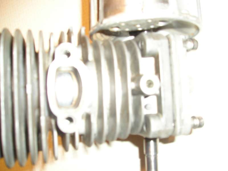

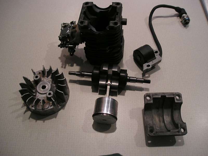

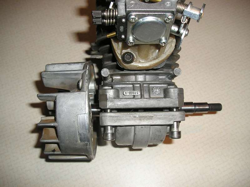

Thanks for the replys and a special thanks to Dave Wallace for providing some sketches of potential design solutions. To help better define the problem, I am attaching some picts of the engine. Any more comments?[img][/img][img][/img][img][/img]
sides7
P.S. the bolts are not the ones for the engine case. Those pictured are over length for the engine unless the mount plates and the coil bracket require some this long.

Old 06-10-2005 | 10:59 PM
My Feedback: (29)
Joined: Jan 2005
Posts: 1,402
From: San Antonio, TX
Default RE: poulan 42 coil bracket
Hi sides,
Your welcome for the nice comments. My ideas will work, but you may have to trim the fins over the screw holes and behind the coil position. You will need to buy from Wacker or make two beam mount plates and get new 10-24 cap bolts. That is if you use the basic coil bracket. Good luck.
