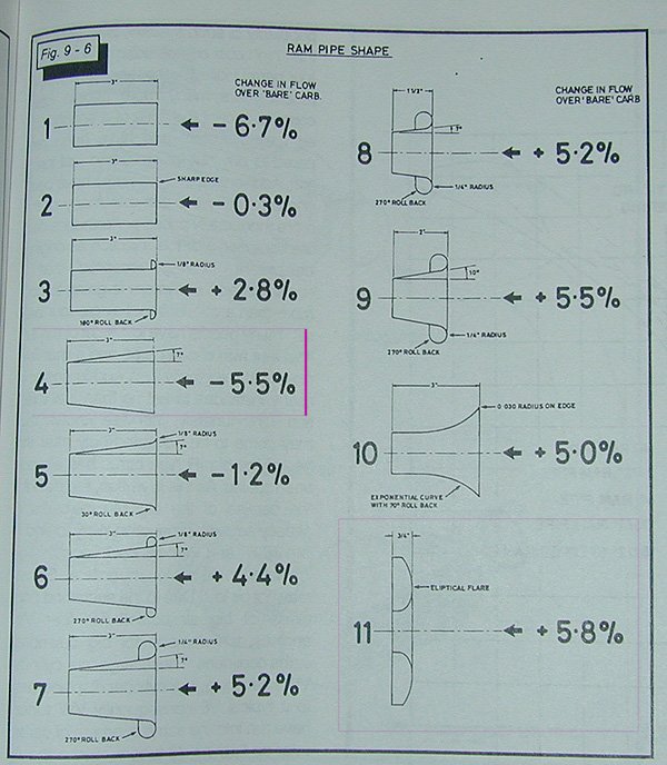

Velocity stacks get their name from the speed your money leaves your wallet on something absolutely useless and power robbing. here is a chart of their effectiveness ( or lack of)

Most of the carb extensions that people are using are not actually velocity stacks but extension devices to try to contain the reversion plume of fuel mist that forms at the entrance to the carb. They just make the needle easier to set and the plane a litte cleaner.
At least that's my experience.
Enjoy,
Jim
