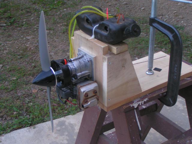

I finally got a chance to make a test stand and tach my little Echo Kioritz today!
Still all stock for now but I was supprised. It turned a 16x8 APC at 7000 rpm then
I took the little deflector plate and spark suppressor screen off the muffler and it
turned 7800 rpm all with my Tower Hobbies digital mini tach. I don't know how
accurate it is but it seemed pretty consistant. I have a larger carb to try and I am
going to experiment with some different muffler designs. I will post #'s when I do.
Pete

Default RE: Fired up my Echo 23.6cc today!
Well I tried another carb tonight It was a WT312 of a non running Mac weedie I had given to me free in a bucket. It has a bigger throat than the original carb but I couldn't get any more than 6500 rpm I tried adjusting both the high and low needles but it just wouldn't rev out. At least I got a free bucket! I'll have to try a different carb.
Pete

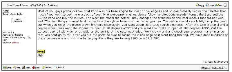

I am attaching a jpg of the don't forget thread with Kieth Bakers BME mods for more power.
Dave

Old 07-08-2005 | 07:02 AM
Joined: Sep 2004
Posts: 203
From: saegertown, PA
Thanks Dave,
I do have that printed off I also got some tips from another member here Fastratporting service
I will be trying both I just want to do everything in steps and see what gains I get.
Pete
