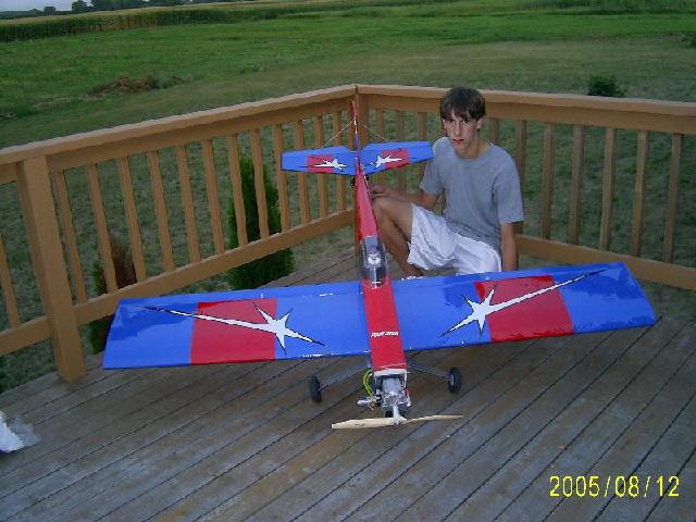

Hello,
Just thought i`d give brief rundown on my 120 Fourstar with the 31cc Ryobi. Great combo in my opinion! for anyone looking for a plane to put the Ryobi in. The plane came out just a tad over 13lbs. Moved the firewall back about 1.5", put servos in tail, still had to add little tail weight. Its a 31cc 2ring engine, so far been getting around 7,800 rpm with an APC 18x6W. Excellent verticall perfomance, was pleasntly suprised. I used the Paragon conversion kit, except for the muffler which is from Bennet. I used the primer bulb and choke, but dont think the primer is necassary. It does need to be spun over fast to start though. With a fast spinning starter it starts imediately. Has been super reliable so far, and excellent idle. I only put a 14oz. tank in it, but will run forever. I think glow powered planes are becomming a thing of the past for me
Love the cheap reliable gasoline powerd engines.
Gregg
Love the cheap reliable gasoline powerd engines.Gregg

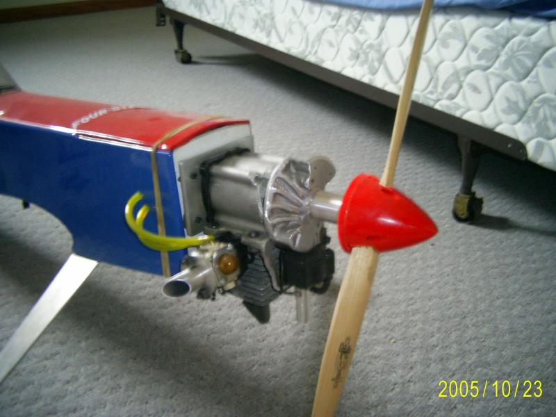

The sticker on the weed eater says Ryobi 705R. I bought it last fall, from the Lawnstation on E-bay. As I recall it was listed as "Non-California Compliant". im assuming it does not meet there polution requirements. It has the long shaft also, which i like better compared to an older model 700r that i had with short shaft.

Ramduster,
I`m just using Hobbico CS64`s High Torq BB servos all around. Seem to be plenty for this plane. Its not a fast plane, but excells at slow flight. I might be wrong, but I think there made by Hitec. About $28.00 a piece from Tower. Its not a 3D plane by anymeans, but a great flier. I need to tweak the idle speed a little on the Ryobi, try to get it to slow down little more. The plane is quite the floater on landings. Also thinking of getting the heavier landing gear from TNT, the stock ones are real light and springy.
Gregg,
Gregg,
Bill

Bill,
This is gonna sound rather odd, but I just drilled a 1/2" hole through the Fuse right above the tail wheel and put a 1" or 1 1/2" long half inch bolt, washer and nut on it. seemed to be just right.
might look a little odd, but can't really see it anyway.
It serves the purpose, cant be more than couple ounces.
Gregg

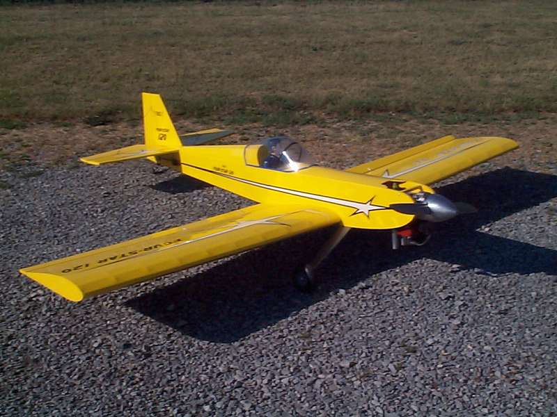

Hello,I built a Four Star 120 with a Homelite 25cc weedwacker engine a few months ago....it took about 2 months from start to finish working on and off...The kit went together super smooth and my homelite pulls it around very nicely,the weight is around 14 lbs I belive. I also put the servos in the tail but left the firewall where it was and cut the cheeks off.Flys great...Enjoy,Dustin
ORIGINAL: hockeydust18
How far back in the tail are the servos? Are they under the horizontal stab? How far forward from the rudder hingeline?
PLEASE BE MORE SPECIFC

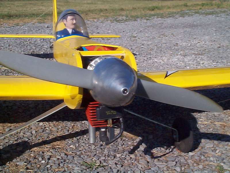

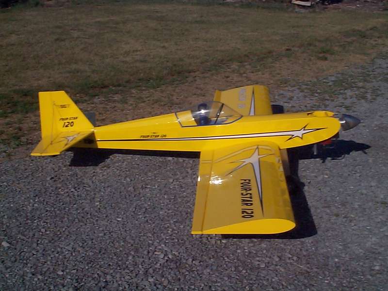

Hey Rcpilet,I just took some more pics, Both servos are in the tail ,they are big hitecs,i forget the number, they are staggared to each other so they dont rub behind and they are both parallel to the horizontal stab,you can see in the pics the furthest foreward servo is in line with the leading edge of the horiz. stab,hope this helps...Dustin

Hi,
Nice job. Since you didn't have a carb sticking out of the back of your motor, leaving the nfirewall stock is ok. You have to move the firewall back with the Ryobi to keep the cylinder where yours is on a stock setup. I guess it works out the same.
Dave
Dave
