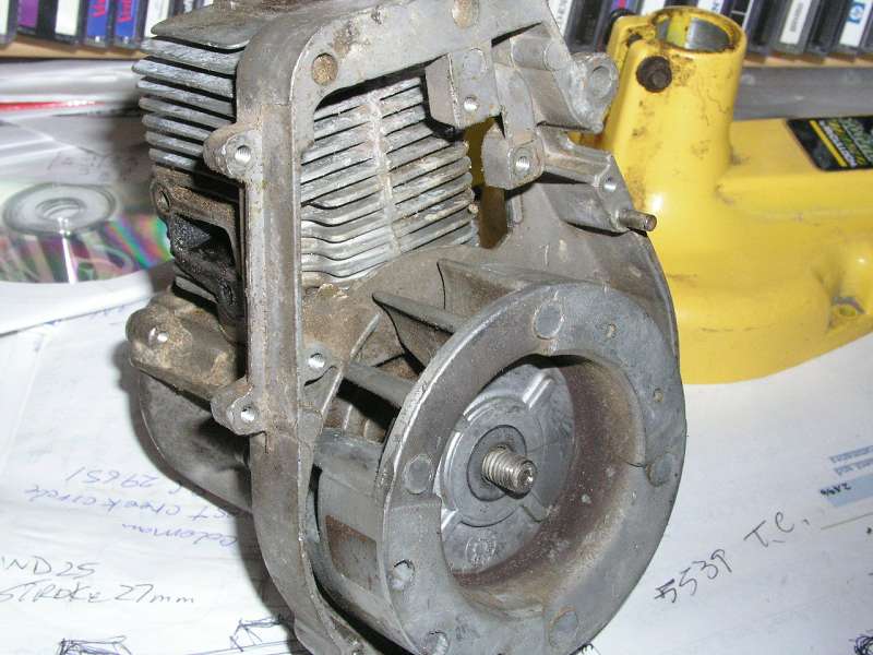

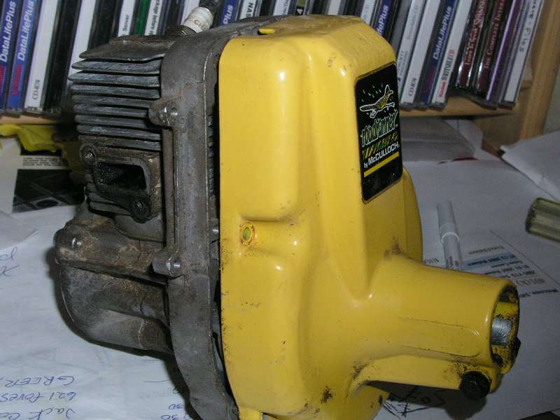

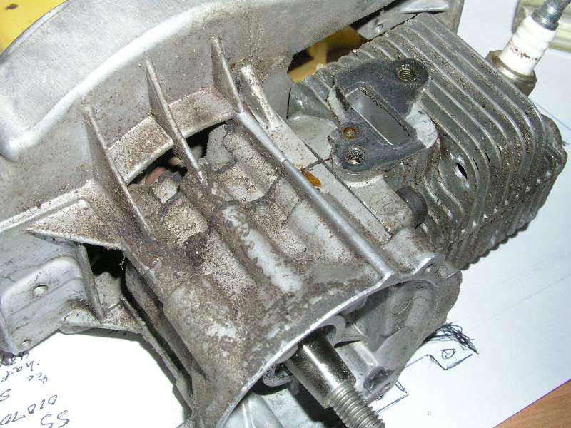

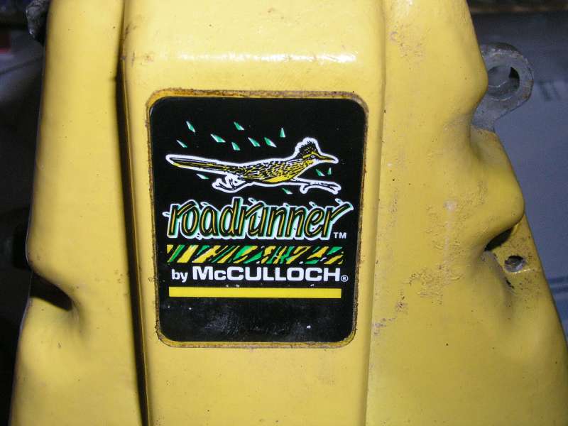

Hello Everyone,
My garbage man brought me a Mac trimmer today. It looks like a Kioritz engine. It is a Road Runner model. Has anyone seen one of these? It is well made and light weight.

Hi Dave!
Your right! It is a Kioritz. The ones with the squared clyinder like yours are the largest cc-wise and may be as big as 25cc. More likely over 22 anyway. I have never measured them. They seem to be well built little engines but there is quite a lot of differences in port sizes and bearing types between outwardly similar engines. Also not all are solid state ignition. They were used by several brands but most often are McCullochs...........farley9n

Hi Bob,
I broke out my measuring stick and came up with 21cc approximately. The exhust bridge and offset plug interferred with perfect measurements. Come to think of it my math might be slightly off also. Anyway it is a 21cc Mac. I wish that the flywheel wasn't so heavy. Another neat toy to tinker with sometime.

Don't know for sure, but Kioritz and Echo are pretty high dollar engines, I don't think McCulloch would buy from them to make weedeaters..McCullochs were made here in Lake Havasu City, Arizona before they went bankrupt...Harbor Freight bought some of the finished ones and 2 guys here in Flagstaff but tractor trailer loads of unfinished stuff....I think the name went to China, like SuperTigre.....
A Koritz should have the Echo symbol, a stylized "E" somewhere on the case or cylinder...Looks like 3 small Christmas trees on their sides to form the "E"...

Here, McCulloch has some relationship with Electrolux.

I have several of these and they are 18-21cc . They make decent power for the weight if you use electronic ignition and do away with the mag .

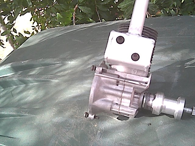

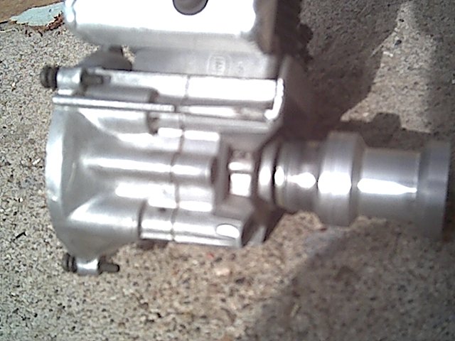

Dave,after reading this post i went and looked at my engine i pulled from an eager beaver by mac.its 18cc.as seen in the pic it weighs 38oz.im going to try a tim6 on it.it was a points engine anyway.you can just barley make out the E on the side of the cylinder under the lower exhaust bolt.the muffler came from ken lambert.

Buck
I think yours is an echo it has round cylinder fins the macs have square cylinder fins and a different carb adapter but the same muffler setup

Buck,
The case is the same as mine, but from what I can see of the cylinder it is round rather then square. Mine has a single pinned unpinned ring and stamped aluminum rod. Kioritz just increaes the cylinder bore size to create the different displacements from 21 to 25. The port timing on mine is very conservative. Intake=55 degrees BTDC,Exhust=60 degrees BBDC,Transfer=45 degrees BBDC. Yours ought be a great gasser for small planes.

i looked at my case and cylinder and it has the echo(E) shaped x-mas trees like ralph said.i just printed the timing circle and port data from a thread here on rcu.it looks pretty easy to figure out.im going to look at my scrap mans pile of weedies a little bit better in the next few days.he has a metal scrap buisness and has quite a few macs laying around.plus a lot of others.thanks for the reply ken. i figured it was an echo but the E proved it.your muffler looks great on it.one thing nice about these engines the carb is already straight shot from the start.i have the tim6 but im going to get a different hall sensor that doesnt have the angle on it.mine has the bridge in the exhaust,single ring and stamped aluminum rod.
