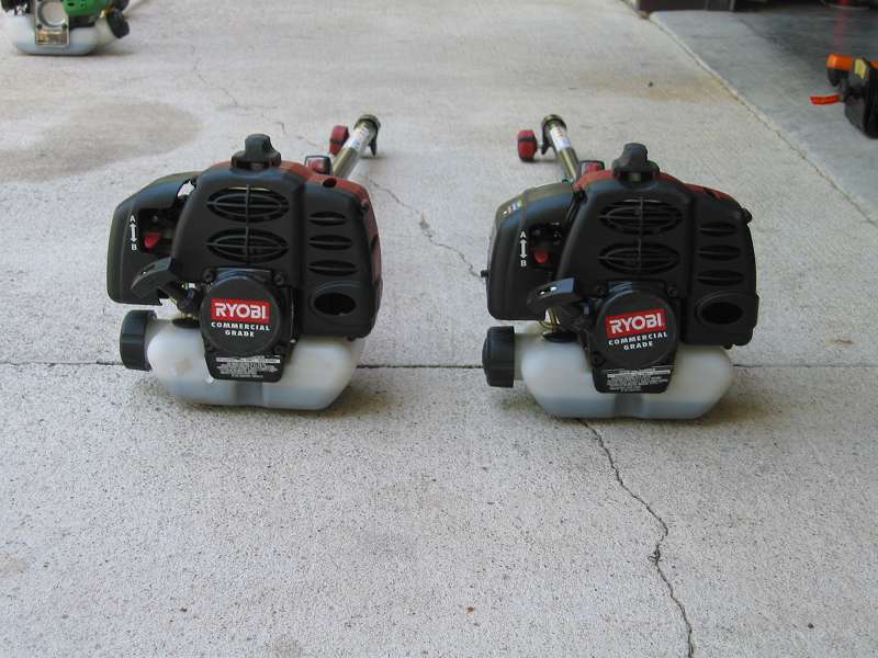

I have recently aquired several new 25 cc and 30 cc homies. And also have some used 25 units. Never having done either I would like some side by side info.
Weight, mag and ignition and glow set ups
power, mag and ignition and glow. Let's say with a APC 16x8 preferably as I am familiar with that one. But I also use 18x6 a lot.
I am going to look into this thing with gassers running on a glow plug.
