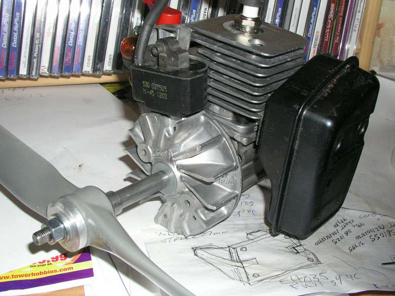

Hello,
I reversed the cylinder on my Weedeater 25cc blower engine. This provides greater room for different mufflers and much better cooling for the hot side of the cylinder. It required trimming back the fins behind the coil and trimming the case coil support a little for the carb flange clearance. Also the center baffles in the crankcase transfer ports had to be removed. They no longer lined up with the cylinder transfer baffles. It weights 55oz. without the muffler.

Neat Job & Clever Idea! Congrats! What are you using for prop shaft spacer? Is prop mounted on orig crankshaft extension? Did you make your own mounting plate? I have a Sears/(Poulon?) 24 cc blower. The rear engine cover is a metal casting w/ 2 round lugs to engage rubber insulators to mount it to the plastic housing. Did you have plane your rear cover flat to fit your mounting plate? Thank you.

Thats interesting what you did. I have worked on a couple of Weedeaters, but I haven't flown one, yet. One point I might question is about the piston ring pin. Did you keep the area of the piston and its ring pin running in the same area of the cylinder that it used originally? The area where it normally runs is wider than the other side. If you lifted the connecting rod from the crank pin and turned the whole assembly, it will all be in the same relationship as built by the factory. Another point I would ask you to consider is using the blower crankshaft the way you have it so far. I have one of these long crankshafts and I don't think I would trust the flatted end of the crankshaft to hold a prop on. I think it would be much better to cut the shaft and thread the end, but it has to be done on a lathe as you probably know, or just find another crankshaft from a Weedeater trimmer. I would be wary of using the long shafts to drive a prop for another reason, the prop is pretty far from the bearings, this amounts to a fairly long cantilever load on the bearings. The airplane when in flight has a spinning gyroscope in the form of a propeller and when you turn the airplane the gyroscopic load is considerable. Remember holding a child's gyroscope toy while it spins? you can feel the load when you move it around and what are they, 3" in diameter. This is long but it it also could be a safety issue. The bearings probably wouldn't last as long either.

The weed eater case and back plate had to be trimmed and filed flat for the mount. The mount is pretty simple. Go to your local recycling center and buy some scrape aluminum plate. I reduced the lenght of the shaft by about 5/8",but I could thread it and make it shorter. The pinned ring has been moved from the exhust side to the intake side where it Has more roomto run. It was very close to the exhust port stock and got worse when the exhust was widened. You don't have to flip the cylinder, it just makes more room for the muffler. I took the Toro flywheel nut to the hardware store today and determined the size of the stud. It is 8x1.00mm. The rear stud is 8x1.25mm. I am going to need a prop hub also. I checked the stock timing on the Toro and it is: Intake=60 degrees btdc, Exhust=65 degrees BBDC, Transfer=51 degrees BBDC. Teh intake is the same as the stock Homelite 25, but the exhust and transfers open a little late.

Hi Dave, I looked at your Weedeater again. My FL-25 and the two 21cc engines I have, don't have your bigger type muffler. My Weedeaters have the smaller silver ones. I am in the process of making an aluminum muffler for the FL-25. This is a bit of a challenge since these mufflers are held on with springs and not bolts. I see why you reversed the cylinder. I converted the two 21cc Weedeaters first. With the first runnings, I got 6000 RPMs with a 16-8 MA prop. They run pretty smooth so I started modifying. I cleaned up the ports, I opened the intake a lot, I drilled the carb spacer to 1/2", and changed the card to Zama carbs from 32cc MACs. Now I get 7000 RPMs with the same prop. I did one other thing and I am not 100% sure if it was necessary yet but I like the way they run, still smooth and a bit easier to start. I machined .030" from the bottom of the cylinders. 7000 RPMs with a 16-8 prop from 21cc seems like it will be usuable. The FL-25 has more compression to begin with and the ports are also bigger to begin with so I am interested to run it after the conversion is finished. I am going to change its carb also as the main change. I hope it runs as smooth as the 21cc versions. One other point is that these engines are not terribly loud without a muffler so that is why I am making a muffler to try on the 25. (Working on these engines has become another Hobby in itself)

I don't have prop hubs for my Toro single carb or Makita 24.5cc yet, so they havn't bee run. The Makita takes a 6mm. I don't know the pitch for the Makita yet, it is the same as the G23 Zenoah. It would be nice if you could post some pictures. My 25cc weedeater has a four bolt aluminum back plate. I have a 18cc with a plastic four bolt backplate. I trimm them and sand the back plate flat for the mount. I don't have the equipment to turn down the cylinders for compression increase. You really got good performanec from those 21cc weedies. If the 32cc Mac carbs are the same as the 28cc they would be a good choice for the 21cc. Mine is a 10mm Walbro. I planned to use it on my Echo 21cc and put a 11mm on the Mac 28cc. Using a 5/16x24 bolt on a metric prop hub is a good idea. That is how my Echo 44cc is setup. I planned on doing this with all metic shafts and I use a standard bolt pattern for all of my mounts. I hope that I anwsered all of your questions.
