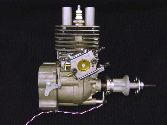

I beleive that Kieth Baker at BME did one. Here is a picture of one. Not a 100%, memory is falible you know.
Dave

You might be surprised to know that the Tecumseh 49cc is only rated at @ 2HP while the Homey and the Poulan are rated at @ 3HP each.... I was surprised to find this out myself... not sure why there is such a difference...

Well, the Tecumseh I have came off a roto tiller. I'm sure it's ported light for low end torque, and probably has a smaller carb. If that's all it is, then I could do some porting and install a larger carb to get the power up. However, if it inherently has quite small transfer ports or something like that, it could be a lot more difficult...
Guess I won't know until I tear it down and check it out real well. I was just hoping someone here had some experience with this engine. Looks like a nice easy conversion, but I'll have to investigate further to see if it's worth doing.

The Homey and the Poulan have large ports,high compression and advanced port timing. Here is a picture of my Homey cylinder as an example. Next time I will reduce the resolution.
Dave
