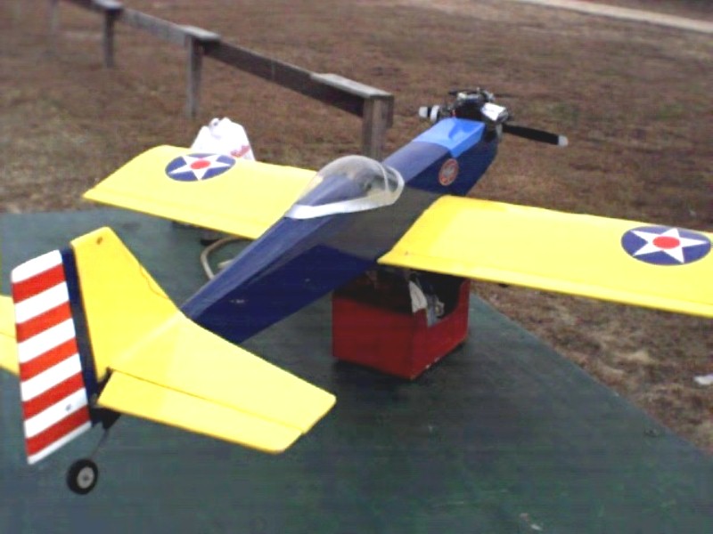

A master airscrew 15x8 fly's my sig fourstar perfect. A 25CC weed eater engine

I would agree with AV8TOR , I have an electric cub that has a belt drive reduction set up, evryone in my club said try this and that size, It amazed everyone that It flys great and goes off the ground, loops and almost hovers with an 11x10 ,yes awsome pitch 10
