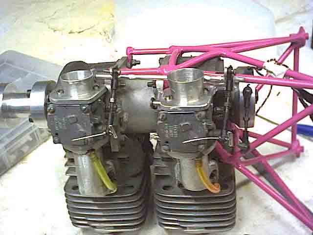

you mean like this?.....
this is two 88cc huskies set for an alternate firing.....it sound like a very upset swrm of hornets it powers a cut down Nosen mustang pylon racer. it will spin a 24 x24 prop at 9000 on the ground. the coupling is a steel affair with new keyways cut in both shafts and coupler

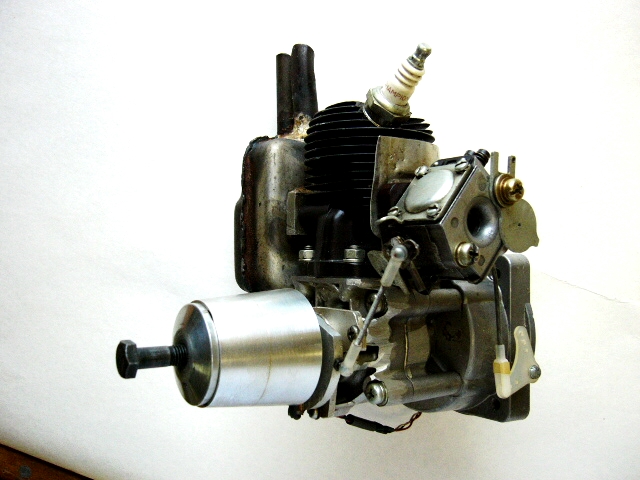

I built a Kawasaki 25cc inline twin. Blade and slot drive between the two.

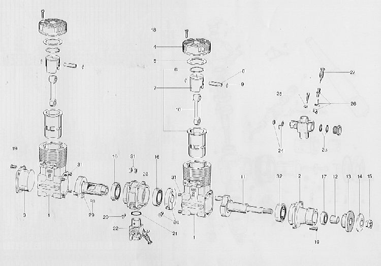

Might be easier with cantilever cranks, this is from just engines site. It's the moki 360
Old 08-31-2005 | 08:10 AM
Rupurt's Avatar
Joined: Apr 2004
Posts: 694
From: Cape TownN/A, SOUTH AFRICA
Default RE: is it possible???
Oh, I see you actually have the engines. My bad, I guess if i where going to do that i would make a sleeve that would fit over the back of one of the cranks and onto the front of the other cut as sort as pratically possible. I would lock the sleeve on the the shaft with high tensile bolts going through the center of the shaft, you would obviously need the holes setup so the engines are 180o apart in there respective cycles. Then I would make up some sort of support to hold the two together, maybe a nicely machined item made from ally barstock. You would also need to syncronize the carbs.

This is the front 25cc Kawasaki that I just took out of a plane using it as a single. The rear view shows the blade slot that the rear motor blade fits into.
ID:	317974   Click image for larger version
