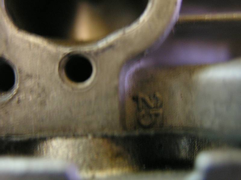

Two Homelite engines were donated to me by a generous clubmember because he knew I convert them for R/C use. He said one is a 30cc and the other is a 25cc, but they both look virtually identical. How do you tell which is which?

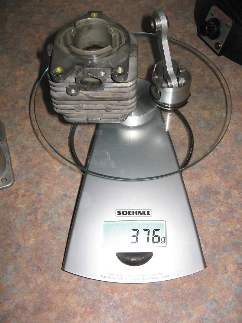

The 30cc jug has slightly larger fins. No points for guessing which is which. If you take off the exhaust the 30cc usually has two rings the 25cc has one and usually a bridged exhaust port.

Hi Tim,
The displacement is cast into the cylinder flange beside the carb mount. See photo.

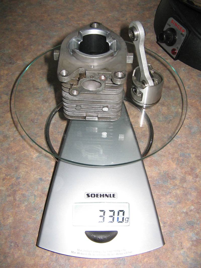

Interesting, I never bothered to weigh the parts like that. That shows the 30 weighing 1.6 oz. more than the 25. My complete 30 weighs two ounces less than my 25, so I guess the extra time I spent removing metal on the 30 was worth it. I recommend using the 30.

ORIGINAL: davewallace
Hi Tim,
Dave
Thanks for the tip. I never noticed that before.

av8tor1977: What did yours weigh in the end?

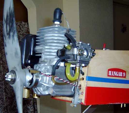

Hi,
Here's the stats and a pic of my Homelite 30cc. It turned an APC 16 x 8 prop at 8600 with only an opened up muffler and a slightly larger carb. Then I modified it...
Homelite 30cc - older design with small transfer ports.
Weight with muffler - 2 lbs. 14 oz. (More cutting/grinding on this one than my Homey 25cc, and this is with prop adapter but without prop or spinner.)
Muffler - Stock, square, gutted, with two brass 1/2" i.d. outlets added.
Carb - 11mm Walbro, manifold ported to match, external pulse line.
Ignition - CH Ignitions electronic set at about 28 degrees presently.
Cylinder - Quench or Squish band removed, cylinder to head clearance set at .020"
Port timing - Exhaust 165 degrees, Intake 148 degrees, Transfers 120 degrees (22 degrees blowdown). All ports cleaned up and entries in crankcase smoothed.
Crankcase- stuffed to .020" crankpin/backplate clearance.
Rings - FRANK BOWMAN'S!!
RPM - APC 16 x 8 = 9400 (Possibly more with tuning and more run time. Also, with this port timing, a tuned pipe would probably give 800 more.)
Test conditions - 4200 feet altitude, temperature 78 degrees, barometric pressure 29.75"
Please also note that while I did modify the transfer port timing, I did not alter the size and I think this would also help. I'll do that on the next one for sure, or use a later model cylinder with the larger transfer ports.
I like it!
AV8TOR
