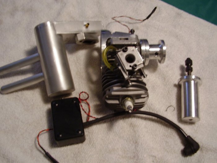

I finished up my conversion and weighed it ready to mount at 4lb. 3.6oz. (67.6oz). That includes muffler, prop hub bolt and washer, carb, and engine. Basically ready to put on the mount and run, minus prop. I then weighed it mounted on the Hangar 9 mounts and it came out to 4lb. 9.7oz. That puts the Hangar 9 mounts at 6.1oz. including the mount bolts.
Are you guys weighing in about the same with your 46?

Great job on the 46cc. Here is a picture of one that someone trimmed down to save weight. I think that RCIG1(AKA Ralph) may have been involved.
Dave
