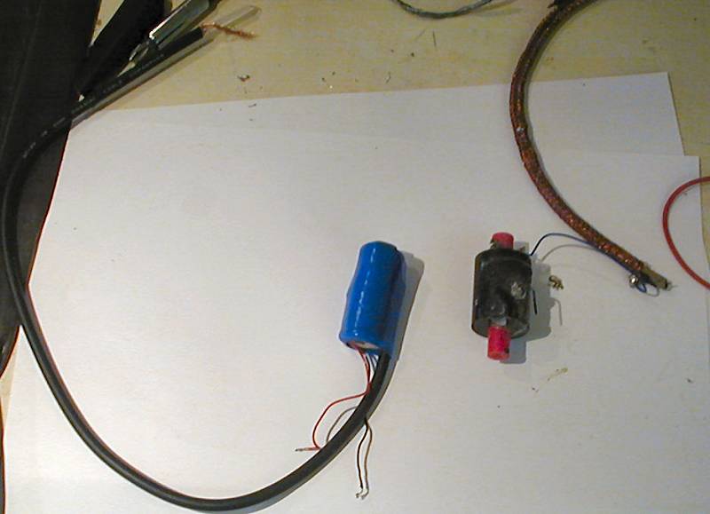

I just made 2 coils from some old transformers. It took some trial and error, but the end result was good.
The spark is just as good as on my CH ignition coils, and the weight is the same, about 40 grams.
The size is also about the same as my CH coil.
I have tested a lot of different ratios, and several ways to wind it, and this is my best results;
Primary: 100 turns of 0,8 mm wire
Secondary: A LOT of turns of very thin wire. I did not count, but the layer of wire was about 5 mm thick.
A short clip of it running is here: [link=http://home.online.no/~jon-mj/Coil.wmv]Coil clip[/link]
The images show the final coil, and a side by side comparison with a CH coil.
I will write a description of how to make the coil later.
Jon-Magne

C&H hasn't used those coils for many years...They're Modelectric coils, made for old time spark ignition engines, 3 volts max with a set of points...They work for a while but the insulation isn't good enough and will break down...Been there [8D]

I have made a page with details of the coil on my [link=http://home.online.no/~jon-mj/homemade_coil.htm]homepage[/link],
You should find all info you need there.
The CDI is from the design on my web.
It is an open source design, but i have not put the latest version on my page yet.
It has programmable delay, a nice test function, as you see on my cideo clip, and uses no special componens.
Jon-Magne
