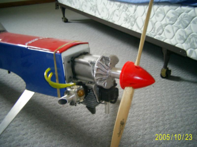

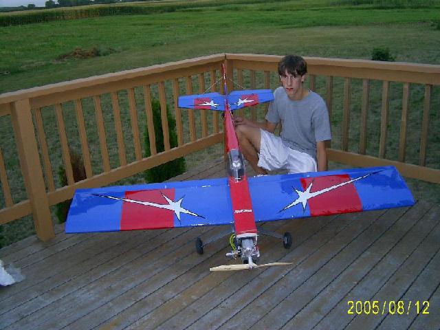

Hello,I was only 15 when I did my first conversion (last year)...It was a homelite 25cc that needed some cutting and parts from wacker engines( www.wackerengines.com )...I only spent about 50 bucks total...It does great on my sig four star 120...not too many mods were needed...take a look at the pictures...Dustin

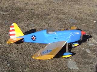

I have converted several motors, Ryobi 31cc (both rear carb and side carb), Homelites 25cc, and thier 33cc chainsaw motor. I have the homelite 31cc side carb going on a 1/4 scale Sopwith Pup, I just did a 1/4 scale Fokker DVII using a fourstroke weedeater that I converted (34cc), a Bud Nosen 1/4 scale Aeronca Champ, 1/4 scale Fokker DVIII using the Homelite 33cc chainsaw motor and I will have a kitbashed 1/4 scale flybaby using the rear carbed 31cc ryobi engine next spring. Oh, yeah, and a Balsa USA 80inch Eindecker that I used a 25cc featherlight poulan leaf blower motor on.
