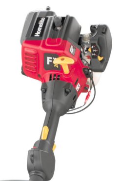

Hi guys,
Sorry to have to ask but as there are so many engines out there I wanted to make sure that this one would make a suitable conversion (and to compound the problem equipment seems to be given different names in the U.K. market ).
Anyway, this weed-wacker is described as a "Ryobi Homelite F2035 25cc Petrol Line Trimmer/Strimmer" - image attached. So if anyone knows if I can make a decent aero-engine out of it I would be very grateful.
Thanks!

The carb and muffler are on the side which is OK.
Is there a good way to make a mount for it? Can you put a flat aluminum plate accross the back of the engine and retain it to the engine with the four backcover bolts?
The Current chain saws can use the Hanger 9 beam mounts. You make an adapter plate from the horizontal split area retainer bolts on the case to adapt to a Ultra Stick 120 motor mount.
Can you make a prop driver hub for the front?
Is the Magneto cil held on by the case of the engine itself?

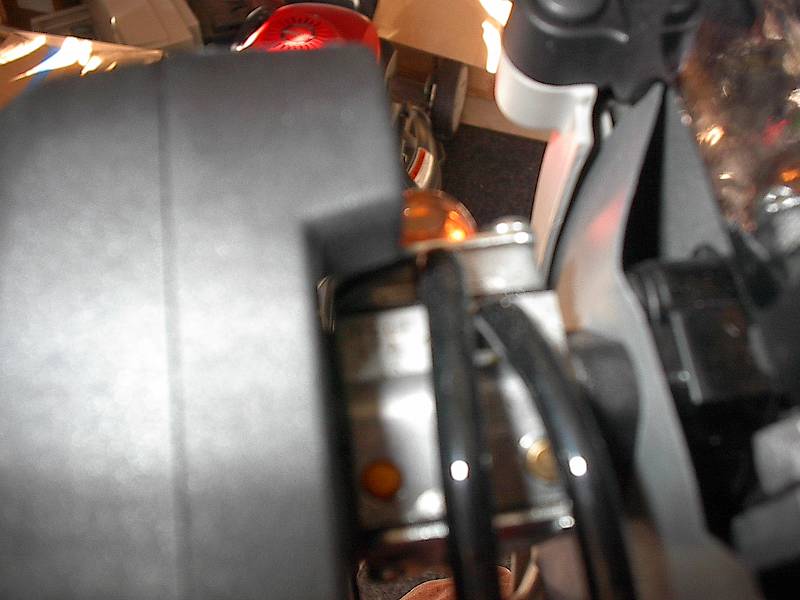

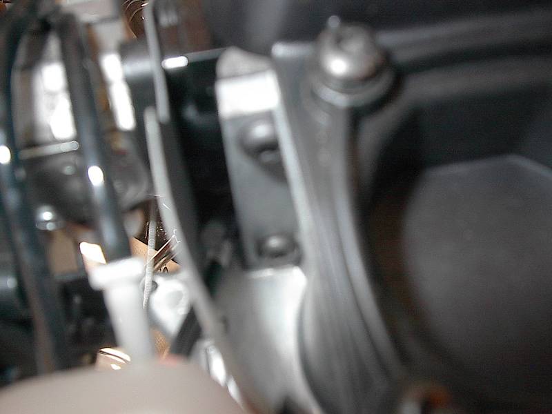

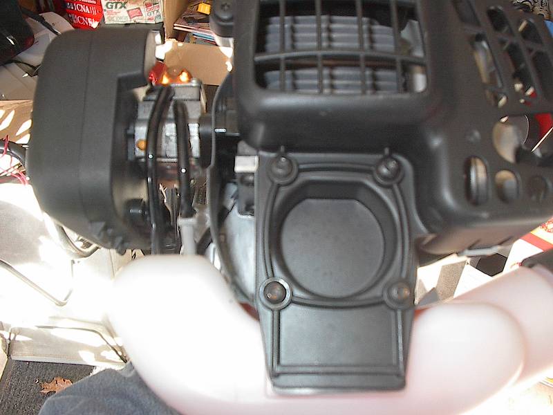

I looked at my "new" ryobi today and forgot that it's a 30cc not 25, sorry. I will still post some pics for fyi anyway. It still looks pretty easy to convert though
Old 11-13-2005 | 03:18 PM
Posts: 1,599
From: Loxahatchee, FL
Default RE: Is this Homelite/Ryobi weed-wacker good for a conversion?
Some pics of the new Ryobi.

That is a homelite 25cc engine. A good cantidate for conversion. Long or short shaft. It will make good power with a new larger carb and a better muffler. It will not be a G26 by any means, but it will be a good running, long lasting engine.
