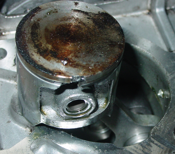

almost a week ago, my engine died. i heard clanking sound and boom, it died. now i have the tools and opened it and this is what i found.
please tell me if this can be repaired. does it need only a new piston? asyou can see, the case have scratches also. what should i do?
thanks a lot for your help and comment.
ernest
by the way its a homelite 25cc from a blower.

Ernest2,you may want to check your lower connecting rod bearing to see if it is still intact.This happened to me a while back also with one of my 25's when one of the needles in the lower connecting rod bearing decided to abandon ship and make a quick exit up along one of the boost ports and finally ended up getting wedged between the piston and cylinder wall.Yup......not a pretty sight to say the least.Kiss one Homelite 25 "au revoir".

turbo, maybe thats the case, but i dont know. the connecting rod (if it is- connectin the piston to the shaft- is a bit loose) i dont know if thats normal or not. but maybe thats the reason why the piston hits the wall.
paulfox, that may be the case there in US but here, engines are pretty pricey. but im lucky on this as its on a super low sale
so do you think there's no hope for this one?

I would say "No hope" sorry to say. The piston and cylinder are junk, and as mentioned, this engine may have bottom end damage as well. Better to go with a new or different engine as the parts are pricey, and for you, probably hard to get.

That small-sh spring in the first photo, do you know what it is from? We had a problem with one of our engines (before anything thinks that I am crazy for using the Royal "We", I mean several of us in our club that do alot of conversions, always great to have a community of nut cases ) when we converted the carb for use, we neglected to remove the ball and spring when we removed the choke butterfly. THis is inset along the choke axle, both the ball and the spring ended up being sucked into the piston and causing much the same damage that you have. This was on a 33cc homelite chainsaw motor. Just a thought.......you should feel priviliged, I only get one thought a day and I am sharing with you

I have dismantled a number of Homelite trimmers that have failed. The most common point of failure is the lower rod bearing. When this goes, it usually takes out the piston and cylinder. One of the boat manufacturers offers a superior rod bearing, it would probably behove one to replace the bearing when converting a Homelite. They also offer welded crankshafts. There are better engines for conversion. The newer engines, from MTD, seem to be much better construction.

actually, i checked the bearing, its intact, no loose needles. what probably is the cause? does a propeller not balanced properly caused this? but if so, why did it happen when it was running at low revs and i was just checking my new mounting. hmmmm. did inverting the engine caused this? because i run it at full throttle when it was upright with no problem.
prop nut, i dont think that is a spring, i think its parts of the cylinder wall that had been scraped when the piston chipped.

The dent in the transfer port looks like it was caused by something tubular. Have you checked the carb to see if something came loose?

no i havent. but i did remove the ball on the throttle (ones that restrict movement) so did the one on the choke.
maybe something did came into the engine. i'll check it again later.

Check to see if the screw that holds the throttle and ckoke plates came out.

What about the spring that was under the ball(s) you removed ?

if there are any spring in there, i didnt remove it. darn!!!
charge it to experience.
do you guys really think theres no hope for this engine? do you think the cylinder is still usable? because i could propbably find a piston here.

You did remove the spring although after the engine was destroyed. It's in the first picture. There's an imprint of it in the cylinder port.
I'm afraid there's nothing about the cylinder-piston - rod assembly that is any good on that engine.
The parts are so expensive and the engines so cheap in the USA, we just throw them away and start over.
It's best that you look for another engine.
Jim
