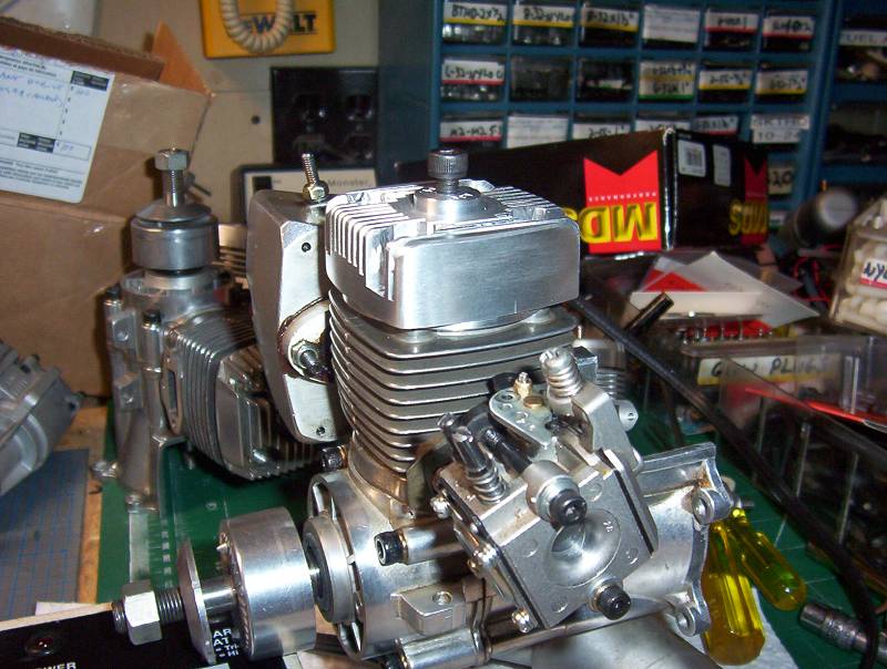

Here's one way to eliminate the rpm drop from heat. Convert it to Diesel.
