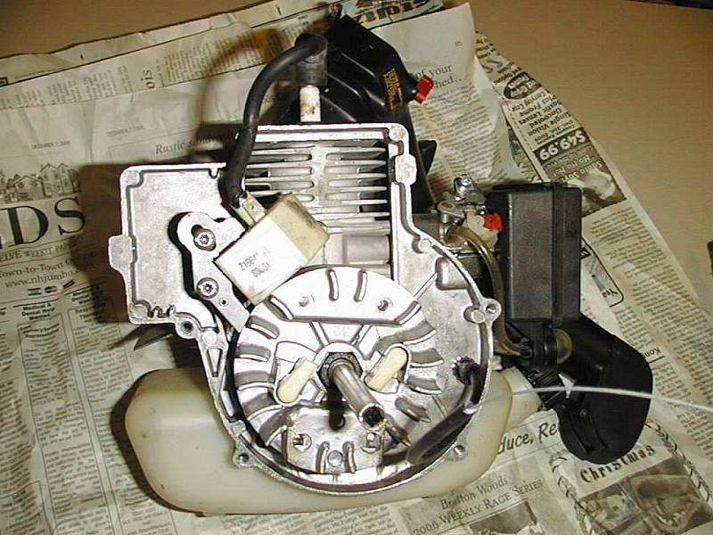

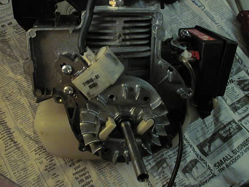

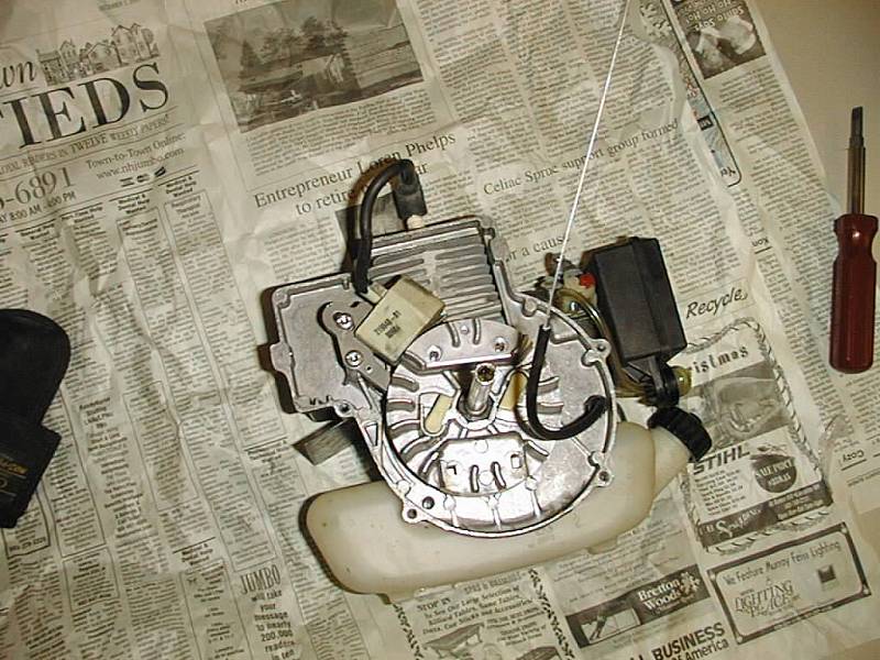

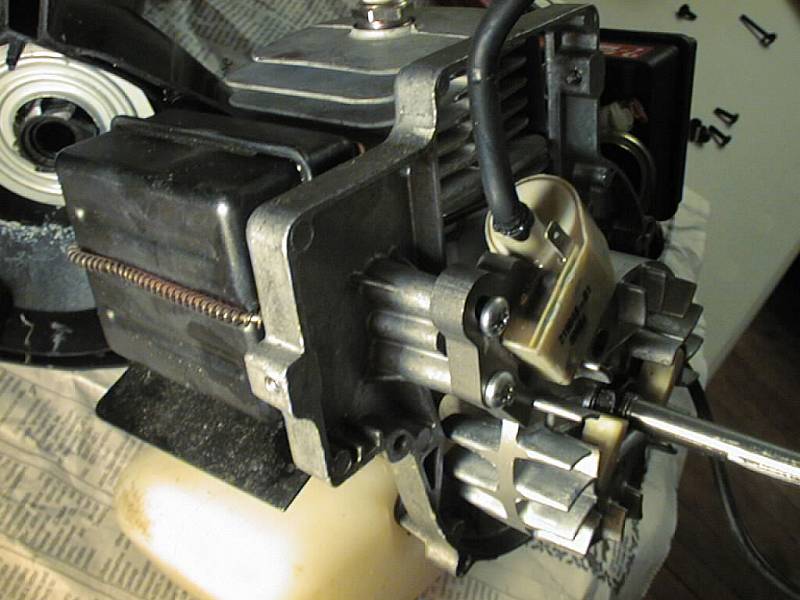

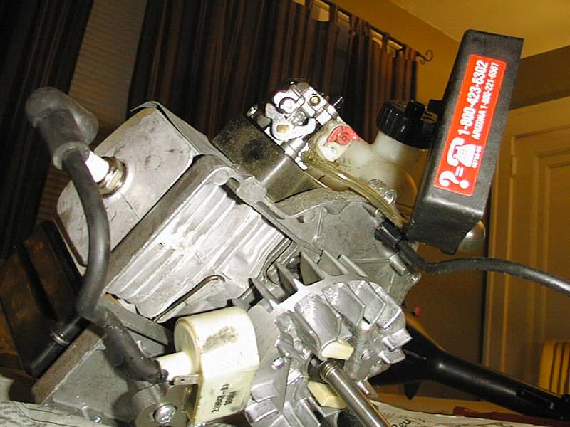

Here is my McCulloch 28cc weedeater engine. I tore most of it down. Can anyone help me in telling me what needs to be done to it to convert it. I would like to do it myself if I can as I like doing stuff like this. A few questions I have:
-- What needs to be taken off?
-- What needs to be added?
-- What needs to be cut or modified?
-- Is the carburetor ok or does it need a different one? The name on it is Zama, if it isn't going to work, I can obtain a Walbro from an 18cc but not sure if that will work as it is from a smaller engine, or will it? The carburetor, if you look at the picture of it, a choke that is connected to the carburetor, it is a lever that is manually moved. Does this get removed or does it stay?
I appreciate any help I can get, and I thank you in advance for your help. Below are the pix of the engine.

Here is a picture of the finished engine from the Carr Precision Site..... And a C-H version
To work better, you will need a carb from a small chain saw but the stock carb will work with few mods.
You will need to cut down the bolt-on bracket that holds the coil toremove any unnecessary metal as shown in the picture if you are going to use the flywheel? Also the outer fins on the flywheel will need to be turned off.
Carr Precision or C-H ignition sells a back plate mount adaptor or you can make your own fro 3/16" aluminum. There is an existing plastic part of the back plate that needs to be cut down the where it is no bigger than the engine crankcase.
Yours has a different shaft than all of mine have had. It looks like it was a blower or non clutch type whacker? I would show a picture of this to Dave Carr at Carr Precision or Terry Grant at C-H so they can get the right hub for you?

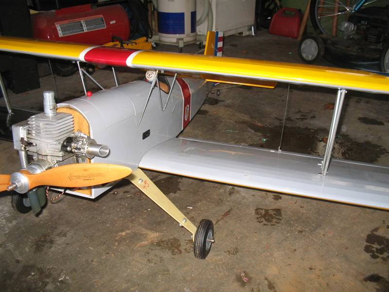

Here are some pics of my Mac 28 conversion. The conversion parts are from Carr Eng, except for the muffler, from Ken Lambert. Milling the fins off the flywheel was done by a fellow club member with a lathe, but this can be done by Dave Carr, also. I also put on an 11mm walbro carb. The combination works well, giving 7850rpm on an APC 16X8 prop on the first tank, then over 8000 as it begins to break in.
