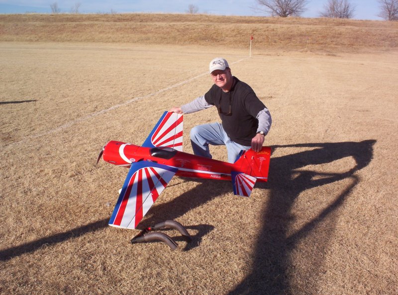

Depends on what you want to do with this plane. I wouldn't think it's a good engine choice for the Superstar. I'm running a Saito 150 and it's about perfect thrust/speed. Maybe something like a Brison 2.4 or something.

Have you noticed the almost total lack of interest in this plane bjmjs ? I started to post a full build review when I got it but from the total lack of interest I ended up just doing a short thread and a few updated modifacation posts. Funny part is , this plane is a great flying ARF. Tracks better than an Edge and is easier to handle than an Extra. The more I fly it the better I like it.
Sure it may look odd to many. But I like having something that doesn't look like every other plane at the field.
