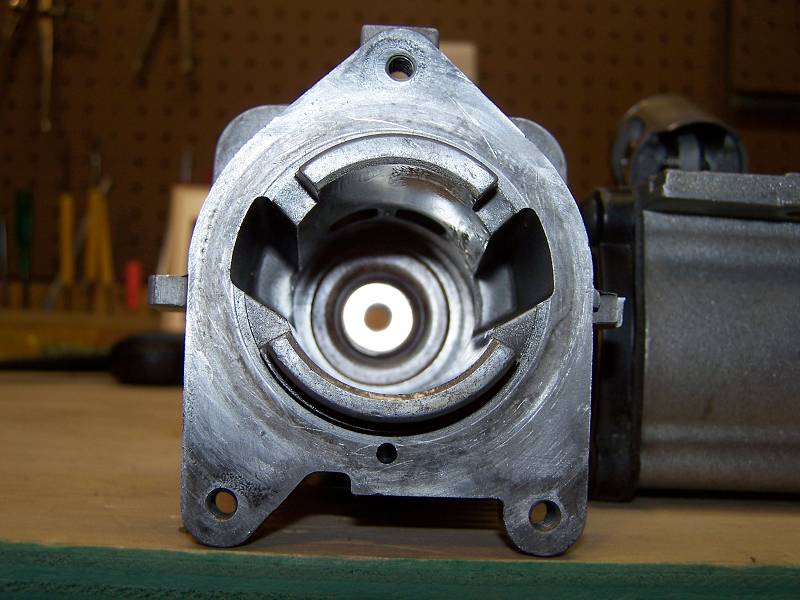

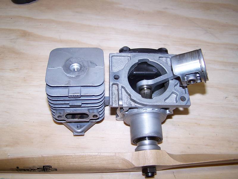

Take a look and guess what this engine is!!! Capt,n

Ryobi?

Homelite 25, next question!!!

25cc Homelite- early style with a chrome bore no exhaust bleed hole and the forged one piece crank. Rugged and dependable......Bob

Hi,
It looks like an early Homey 25 that has been converted for glow. The glow plug adapter is pretty neat, in that it screws in from the inside. This increases compression in the process.

Dave got it right on....got to go now..wife says LETS GO!!!

Plus good set up on prop drive. No long or heavy hub. Just a thrust washer and bolt prop to the crank, ala small glo motors. Works when the crank is long enough. Nice set up, Cap'n, Joe

The idea of inserting the glow adapter from the inside is a good one I like it, have you tried this baby yet???

I have not got everything set up on the 25cc Homelite engine. It may be a good gas/glow mix engine. I will start working on it again...I got my MB290 going and I have about 3 other engines I want to get running also. Best Regards, Capt,n
