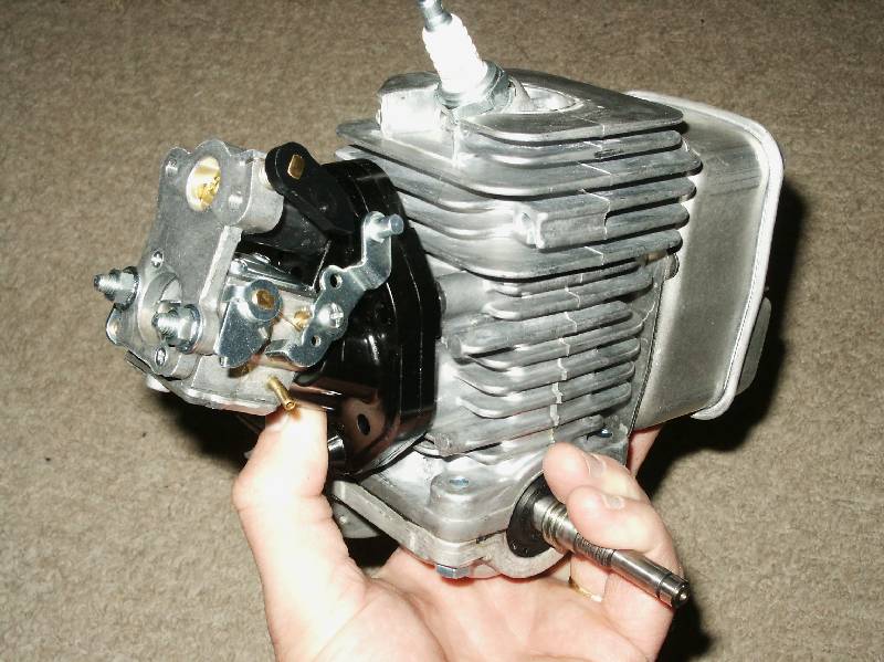

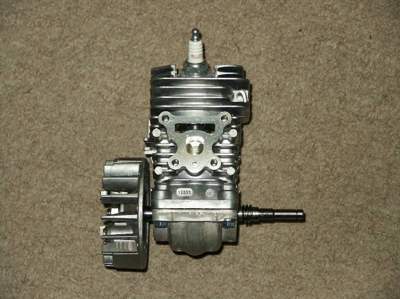

I just got this Poulan 42 cc engine that I am going to convert. It came out of a Poulan Pro 4218 chainsaw. When I took it apart I noticed a second butterfly valve above the carb. This butterfly valve only opens when the carb is at full open also After removing the carb and adapter I noticed another port above the intake port.
Question 1 Is this port for decompression to allow it to start easy or is it for something else?
Question 2 Since I'm going to make a new carb adapter anyway can I just cover and seal this port up?

My first guess is.....
This is basicly a 2 barrel carb.
The main barrel operates like a standard carb.
The secondary does not let fuel in, only air.
If this is like the Torro it should make an excellent engine.
Can you put a regular carb on it? Probally but I don't know all the ends and outs.
How much does it weigh????

At first I thought that it might be like a 2 barrel carb also but wouldn't that screw up the mixture or run more lean at the top end if it didn't allow more fuel (and lubrication) in? As for the weight of it I haven't had a chance to weigh it yet but I will post it when I find out.

Looks like a California job to me.
I think the top port is for scavenging the cylinder for clean emissions
I would be tempted to plug the top port.

This is strictly for emisions it recirculates the burnt gasses(or unburnt) back through the carb. you can block it off other wise it will be really loud like a open exhaust[X(]

Good, now we don't have to build carb adaptors around that old style oval intake port anymore. I need to order some barstock... what is the overall diagonal measurement from the outside of the top to bottom holes???

If that is the 42cc it never had the oval 46cc has the oval

Ive measured the overall dimensions and a rectangular piece 1.5 inch x 2 inch covers the flange perfectly. I'm going to make it out of 1/2 inch thk aluminum. this will also allow me to mount the carb so that there is no need for a bell-crank to actuate it.
