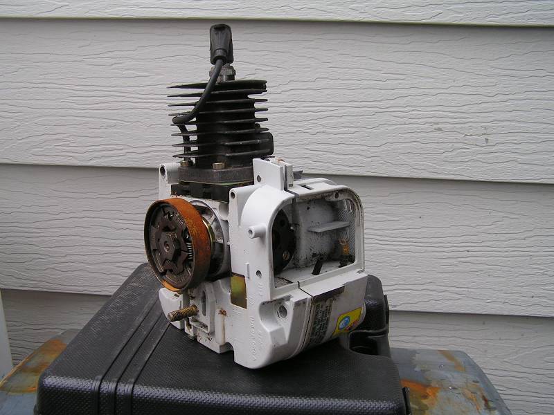

Make sure of the engine configuration when looking at Stihl chainsaws, not all make good conversions. This one is out of a 41cc chainsaw. Crankcase, oil sump and fuel tank are all in one large casting. Long stroke, small bore.
