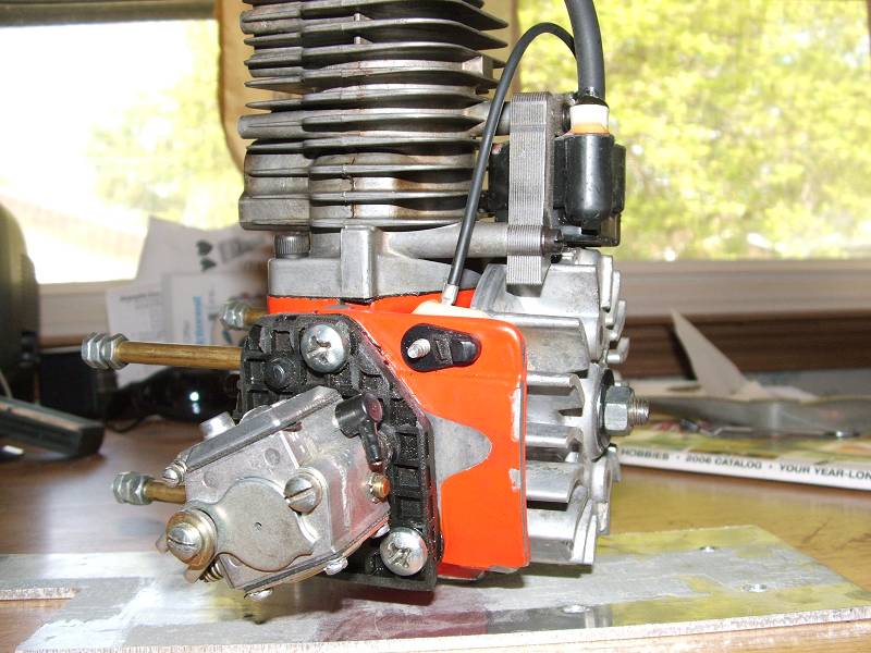

From alot of the topic in this forum, I see alot of " what plane for this engine" or "what size engine for this plane" . For people new to coversions like me, is there a rule of thumb to go by? Or is it hit and miss till you find the right combo? Me for example, Im converting a 38cc poulan. What lbs size plane max will it fly with vertical authority? What size for scale? And prop sizes, do you choose props according to RPM? Whats a guide to go by there? Would love to hear from any and all who know the secrets to these puzzles! Thank You! AL

that pc is not a poulan is it? I don,t recall ever seeone like that or maby Im not old enough. A 38cc poulan should fly a 12# plane but remember there are alwas veribles such as drag and style of flying you want to do, I built a 38cc poulan for a freind and he flies it on a hanger 9 talorcraft it is on the thrird one and still never misses a beat and has plenty of power

Ken.... From all the info I could get, it is a craftsman 2.3/16 made by poulan manuf. date oct. 1983. Figured 2.3{38cc} / 16 {bar size} I ve made a mount out of threaded rod through the 4 holes where the cases are bolted together , double nuted then sleeved each rod with warshers and rubber bushings. Ive got it ready to fire up but need a hub and muffler. can you help? What measurments do you need ? And what the cost for hub and muffler? Thanks! Al Ps Does this engine look like something else to you?

it doesn't look like a poulan to me but I can make a hub and muffler for it . need the muffler port size and bolt center to center. need the thread size and pitch and the shaft size next to the housing.
If it is a poulan it is vary old type I haven't seen before
A few more pics at different sides and angles could help also. Kenneth

Ken... here are a more pics you asked for. And matched up a die to the threads on the crank, it was 8mm 1.0. Measured center of holes to center holes on muffler side. Across the bottom it was 11/2in. from bottom holes on both sides, they measured 11/4in. to the top hole. Is this what you need? thanks! Al

Looks like reed valve induction. Nice big exhaust port....good for rear tuned exhaust. Looks in good shape. Good luck with the project. Capt,n
