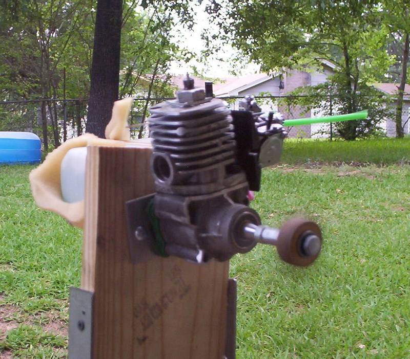

It's doable.I cut off everything even cut off some fins. I mounted it and going to test run it today but i am planning on using FAI fuel with 3% of oil since it got ball bearings.This will make a methanol fuel cheap enough to burn at high rate.

Well,To start with i didn't have a well made glow plug adapter and zama carburetor (1 needle) is the only 1 i had for right now but it ran.I mixed 3% of castor oil in pure methanol and it fired right up.I saw bubbles from so called adapter so i know it must be leaking pretty good but it ran and revved up.I think highest i got was 6200 on 14-8 prop. Not sure if it's good or bad but once i confirmed it's usability it'll go on the front of one of my 60 size trainers.Oh yeah...picture worth a thousands words? here it goes

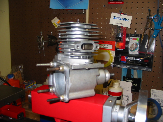

Here is a photo of my 25cc Homlite engine. I took this photo to show another way to mount your engine and save weight. Remove backplate. I drill the bolt hole deeper and re-tap deeper(not needed in all cases) and installed long studs. I use locknuts on studs to hold back plate in place. This engine is glow....then later did glow/gas. Enjoy! Capt,n

Cap'n John,
That mount congifuration is an outstanding idea...I'm going to use it as well.

Thanks Foamcut...I am sorry I did not think to post a photo of this simlpe mount last year! It is simple and saves weight and the price $$ of a special engine mount. Capt,n

That's how I always mount all of my engines that will accept studs in the back.... I'll gladly lose the easy mounting accessability of a backplate style mount in order to also lose the weight!!
