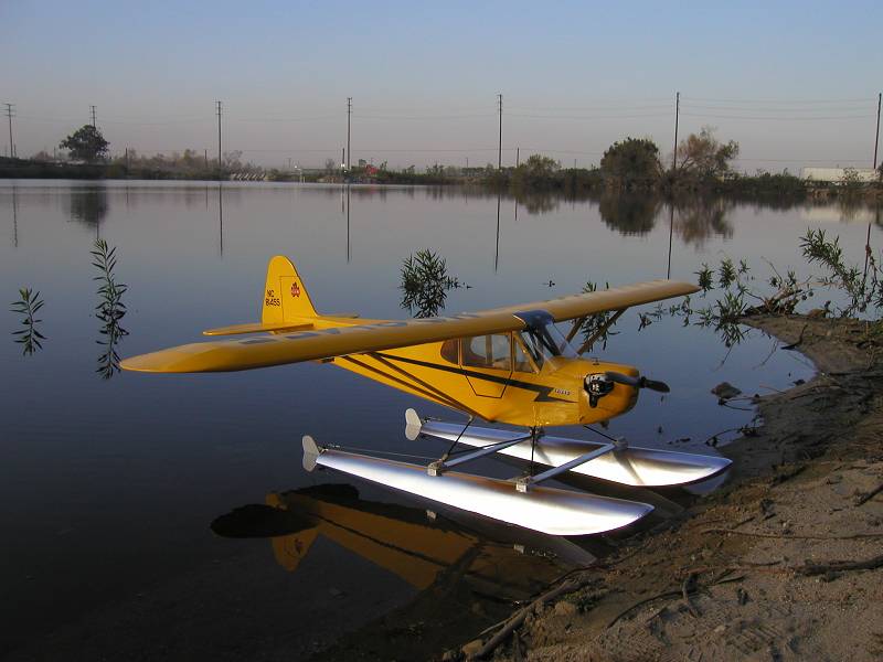

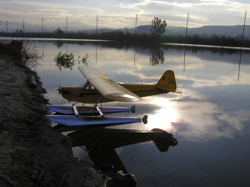

This Cub has flown with a variety of engines including: Zen G23, Zen G26, Very old points ignition Zen23 (KALT22), ECHO 23.6. These 1/4 scale Cubs seem to like any engine that will turn a 16/6 or 16/8 at 8000+ rpm's.
