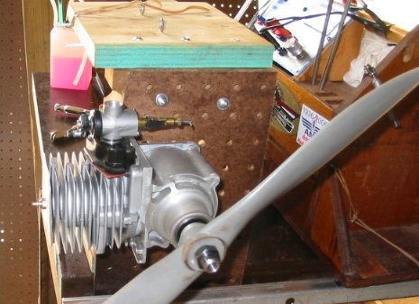

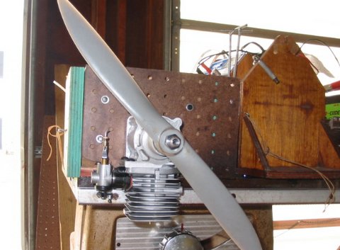

I just ran my Homelite 25cc on 10% Glow fuel. She starts real easy...most times 1st flip. The RPM was over 8600 on 1st run. The only thing it wants to start and run backwards most the time. I am using a Supertiger 90 carb which plugs right into the manifold spacer after sanding to correct size using a dremel sanding drum in a drill press. The carb seems to adjust real good. The idle was fairly slow but did not sound right untill I gave it some back pressure at the open exhaust port with a piece of wood. It then would idle super smooth and at a very , very low RPM. I will post a photo of it hear soon. This engine is so far a freebe...using parts on hand. Like supertiger carb! Next test will be with a Walbro type pumper carb. Then a gas/glow fuel mix. GGL for short. Thanks Capt,n

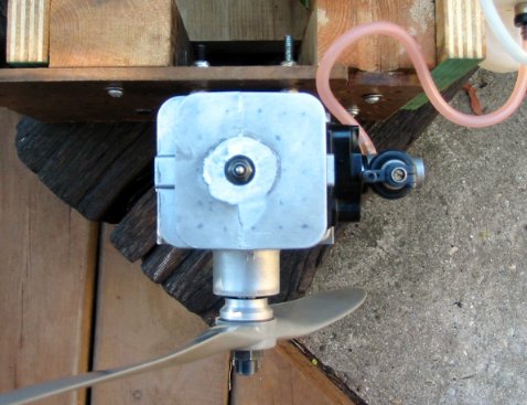

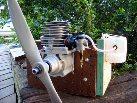

Engine...older (low time)25cc Homelite. I have done no mods to the ports or timing. Did eliminate gaskets and used Yamabond. I have to get or make a exhaust for it. I am sure a little bigger carb could be used. Have not tried muffler pressure yet or the perry inline pump that works off crankcase pressure. Lots of options to try yet!!!! The prop is a 16x6 APC. This engine does not seem to be a nasty kickback type. May get a boman piston ring. Capt,n

Interesting experiment to use the Super Tigre carb Cap'n John, but to tell you the truth I've never had a problem running "Gas/Glow" with the Walbro carbs. I also like the fact that they have a pump built in for steady fuel supply. I usually mount my gas tank farther rearward than normal, about on the center of gravity. That way there is no trim change as the fuel supply gets used up.
If you decide to go with a Bowman ring, I have had great luck with the 25cc Homelites by ordering a ring for use with a pinned piston from him. I then use a piece of .063" gas welding rod to make a pin for the piston so the ring can't turn. Then you can grind out that bridge in the exhaust port for better flow.
I also have had problems with these engines converted to glow quite often wanting to start backwards. Usually flipping the prop to start in a backwards direction will make it backfire and run in the proper direction, or just a quick touch from an electric starter has them going the right way. I had one the other day pop and start back up backwards as I was shutting it down with the transmitter trim. It then backed up into a wall, so be sure you have the airplane secured both fore and aft when you start or run them. They sure start easy and idle slow running on glow don't they?
