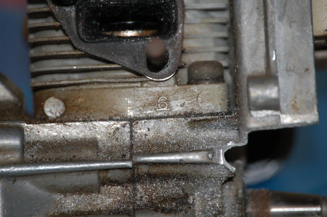

I have a mac engine but not sure what cc anyway to tell by the looks? I'm looking for a gasket set for this engine could someone give me a link to a site that sell's them? I am having no luck finding one!!! Here ar some pic's of the engine in question.
Thanks for the help
Greg

Kahn,
Just go to your local auto parts store and buy some 10 to 20 thousands gasket material. Use a hobby knife to cut it out on a hard wooden surface. For the cylinder base, I usually cut a hole to fit the cylinder base flange. Slip it on the cylinder, then press lightly around the edges of the transfer ports and mounting holes. Trace the impression with a pen and cut it out. Make sure that you allow for the pulse port. I have this engine. It will run on EI or glow/gas fuel and power my GB Ultimate. I cut the center of the flywheel out with my drill press and turned it down in it also. This allows me to use a standard prop hun. The thread is 8x1.25mm metric. The tail shaft was cut off with a Dremel cut off disk. I used the 9.5mm Walbro carb from a 28cc Mac trimmer. Here are some pictures of my 21cc Mac.

Kahn,
I just got it this far recently. I haven't run it yet. It had very mild port timing. I lowered the intake port 1/16" to give it 120 degrees duration and I raised the exhust ports to get 140 duration. Mine has a floating ring, so the ports are narrow to prevent catching on the ports. I modifed the piston also to improve flow. I think that you will be happier with a Homelite 25 or a Toro 25 in your 13# corsair. I am looking at a ten pound plane. Thats why I got rid of the heavy flywheel etc. Here are some pictures. You can see the enlarged intake port in the picture on the right.
