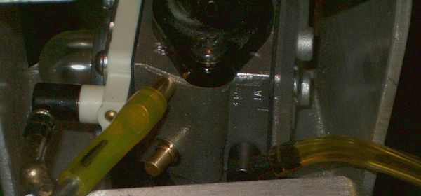

Hi Guys, It was suggested that I start a new post for my project so here it is. I am trying to get it to run for more than a few seconds. I am using a Walbro WT-644 and CH Ignition. Both are brand new. The 31cc, twin ring, Ryobi had been previously converted, (The Best Engines) but I have decided to swap out the Zama carb with the bigger bore Walbro and use the CH Ignition. The pulse hole is lined up but the carb does not seem to be pumping because it is not drawing fuel. When there is fuel in the carb. it starts with a few swings of the prop and runs strong for a few seconds ( until the gas in the carb. is used) then quits. I'll post pictures if someone will tell me how. I am new to this web site. Thanks for your help.

Are you using 2 lines to carb? And are you using primer? Make sure the line are hooked up correctly. Is the battery for ignition charged up good? Good Luck Capt,n

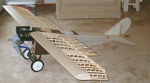

Okay, now I see it. Here are a couple of pictures. Thanks for your help. Also, a picture of my 1/4 scale, scratch built Loening M-8 which I am putting this engine in (instead of the FZ 120). The fuel line is on the right side (fuel pump) and the plugged return line is on the left side (fuel bulb). At least I think I have this right. Guess I'll take the carb. off and check that the pulse hole is clear and whatever else you guys think i should check.

I have had problems like this. Are you using the primimg bulb? I suppose not if the return line is plugged. Did your other carb have this setup? And are you using a choke plate, or manually choking it to start?
My guess is 1) pull the carb and clean it. If it is not pulling fuel, something is whacked inside, dirty, stiff, etc. or 2) check the gaskets on the carb/spacer/motor. If they are not sealing, you won't get it running past a little bit of throttle. Air leakage in these areas will kill it.
the problem is most certainly the carb.

Well guys, Thanks to all who have been very kind to respond my Ryobi is running! I am using the fuel bulb and it seems the better way to go since it kept me from flooding the engine. Just have to work on a new starting procedure when at the field. Once started it starts every time with a flip of the prop or two. Still need some break in time and I am running rich for now. Using a M/A 18-10 until I am satisified then I'll go to the 20-8 or 20-10. Oh, don't know what really fixed my problem but I just took everything apart and started from scratch. Reset the TDC and timing also. Cheers!
