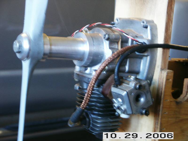

Find out what the engine came out of and look it up on Kioritz site for parts manuals. 21 and 23 cc kioritz normally have plug tilted to side. 23 is going to be gas/glow.

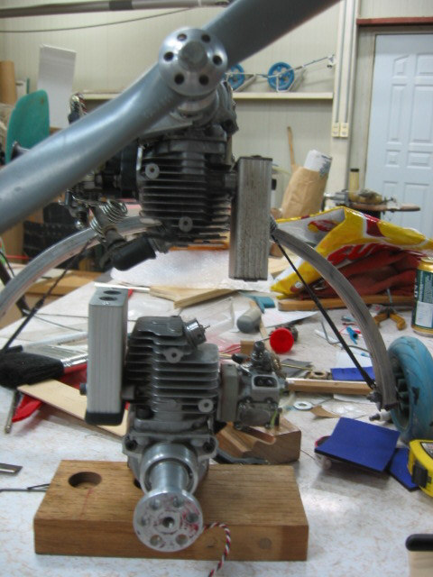

None of my Kioritz/Echo's have a forward pointing plug. Mine are all like Mike's

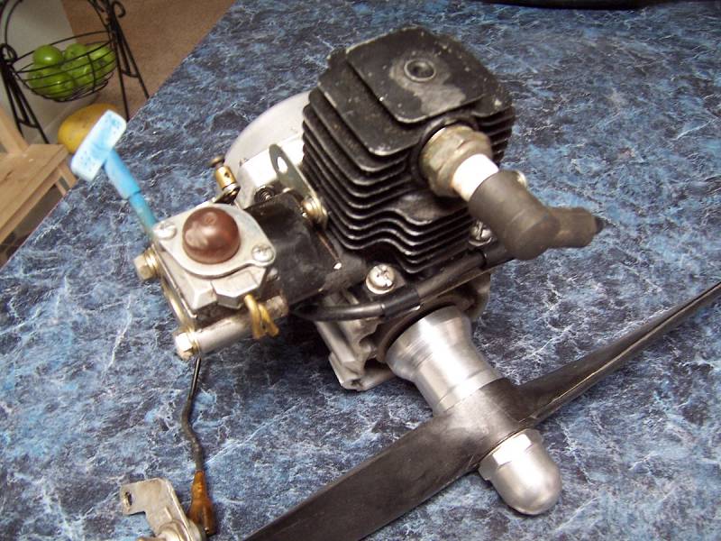

Hi,
Went out and took a picture of my Kioritz K3s came out of a 21 CC Craftman string trimmer. It had the front fan and clutch. The flywheel was heavy and round without fins with the mag and points inside. It was mounted in the housing at the back of the engine. The housing was a ready made engine mount. The one problem with it was that the output shaft was not tapered making it difficult to attach a prop adapter. It is set up to run on CH igitation. It has a gloplug adapter in it and will be a great engine to try on GGL that seem to be a great way to go.

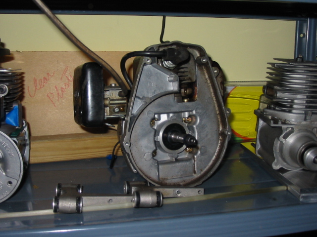

The first string trimmer I bought was the Sears 21cc engine. Mine has a mag on the back with points in it. Runs good but I do think it would be best as GLOW and 2nd Gas/Glow. Any extra weight needs to be gone. May post a photo later. Capt,n UPDATE Added photo

Yes, I think that's the same engine. Mine has a small tab rivetted to the housing that says "Koritz K3s" on it.
Its a nice quality engine. I cut off the rear crankshaft just past the rear bearing race and replaced the seal with a plug that I turned from a piece of aluminum using the points screw holes to hold it in. The flywheel is so heavy it think it weighs more than the rest of the engine. Get rid of that FW and its a very decent weight.
I also whittled a carb adapter so I could rotate the carb. I think you'll like it on Glo or GGL.

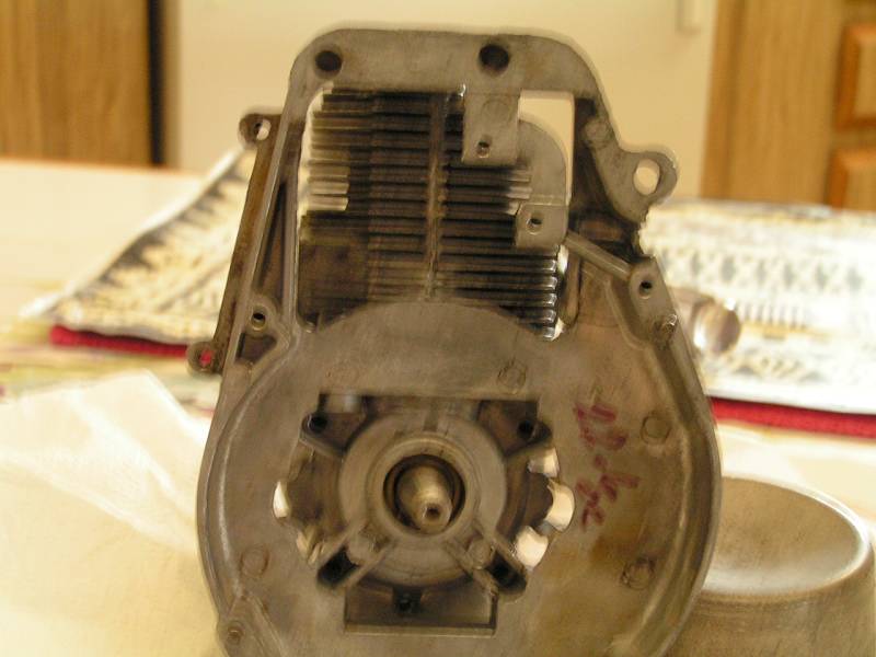

Wufnu, No, it's not necessary to cut off the crank. I had mine apart for new bearings, I cut it off with a hacksaw, the shaft isn't very hard. I then cleaned up my cut on a sanding disk. I just wanted to lose any weight I could. Some on this engine conversion forum have used an old capicator case for a plug, but I didn't have one. With the proper size plug pressed in, screws to hold it in would be uncessary thus even less weight.

Wufnu,
Sorry, no pictures at present. The shaft goes through the bearing then through an oil/dirt seal thats about 1/4 inch thick. By cutting the shaft at the bearing a person defeats the seal and needs to reseal it some how (that's what the plug is for). If you cut the shaft outside of the seal then you'd not need a plug and I'm sure it would not be any heavier than with the plug setup I used, it just leaves a potiential spot for leakage either in or out). I also saw it as an opportunity to reduce any drag that the seal might add to the engine (however minuscule).
