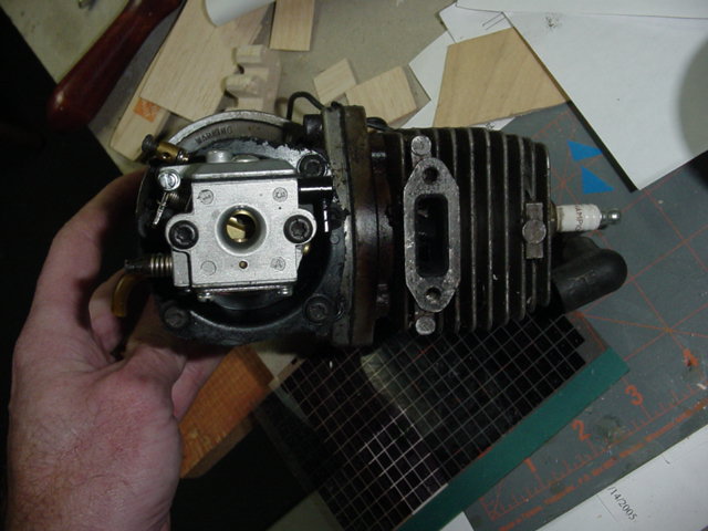

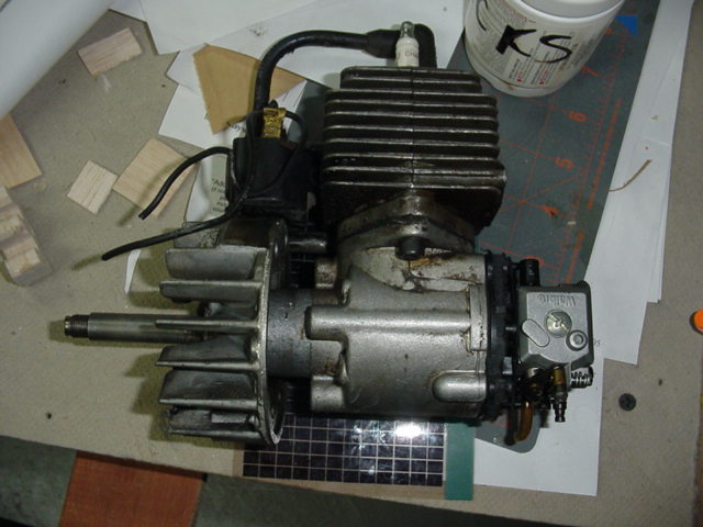

Hi,
I just pulled this Ryobi out of a Turf Power Model 720TP weed wacker. Can anybody tell me what size it is??? I know it's smaller than my Homey 25, I'm guessing a 15 cc???? I've found the parts breakdown on the net but I can't seem to find anything on it's size.
Chris

It looks just like my two 31cc Roybis that I salvaged from a pair of weedwackers that I paid $10 for.

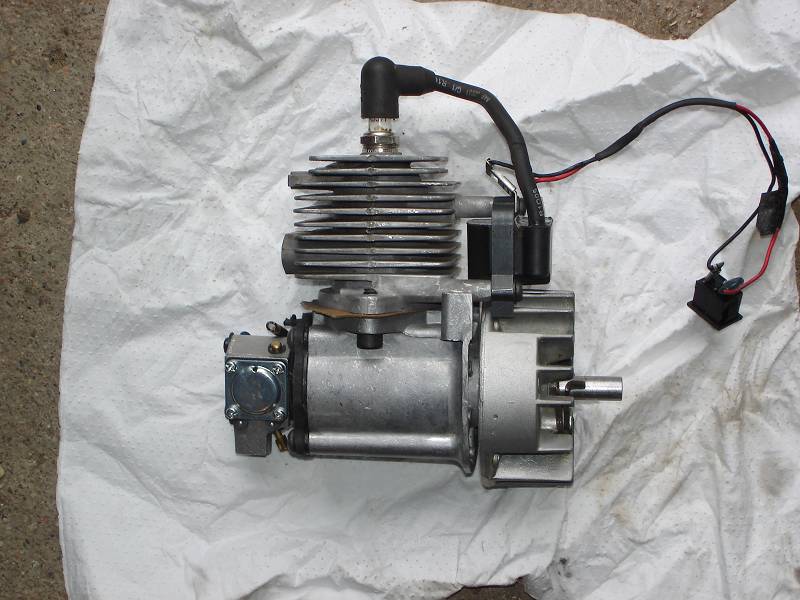

It looks to be the long shaft ryobi 31cc....
i have the short shaft out of a yardmachines 2800M and it looks like this: (after the conversion process)

Ryobi only makes either a 30 CC (newer models) or 31 cc.

That looks like a Ryobi 28cc. It was the predecessor to the 31cc and you can tell the difference between the two because on the 28cc the front metal flange was bolted on rather than being a part of the crank casing. I see that's been removed in your photos. I remember the 28cc because it was the first engine that pulled out of a strimmer and I still have it somewhere.

The 28cc Ryobi has a slightly different cylinder fin configuration at the spark plug. The 31's have a full top fin as in your pictures and the 28's a couple narrow fins at the plug. Somewhere I have pictures of this and if needed will gladly post. Other than the fins the two are for the most part identical..............Bob

A long time ago, I asked how to tell the 28 from the 31, and I was told the only way to really know is to pop the cylinder and measure the piston diameter. I'd love to know if the fin thing is correct, or some other easy way of identification.

I've just looked at my 28 and 31 Ryobi's side by side. The 28cc has the earlier fins as described by Bob above and the earlier crankcase as described by me. The 31cc has the later fins and the later crankcase. I have no information on the order in which the changes were made during production and whether they were in any way synchronized with the change from 28cc to 31cc. So if one really did want to know whether it was a 28 or 31cc then measuring probably is the only way.

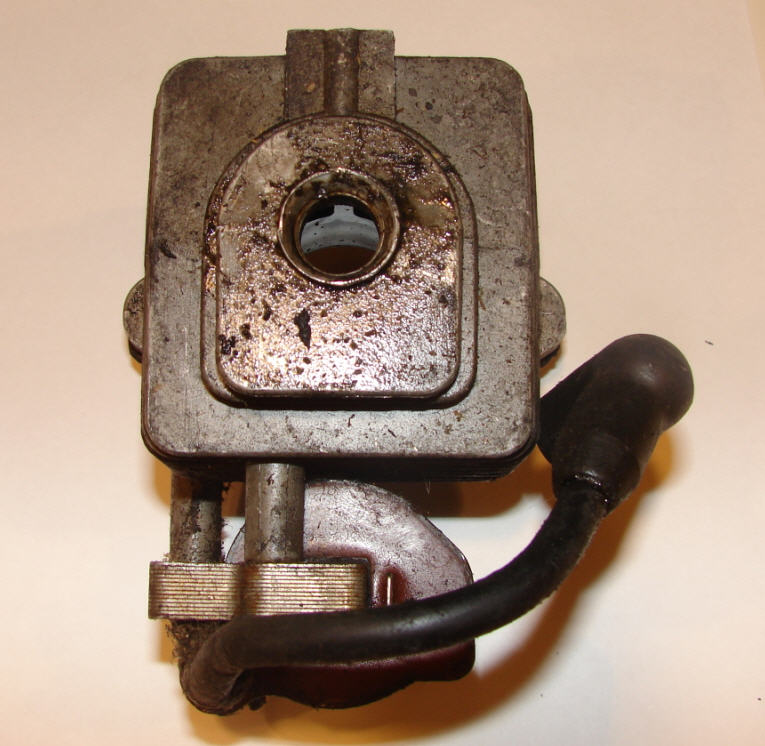

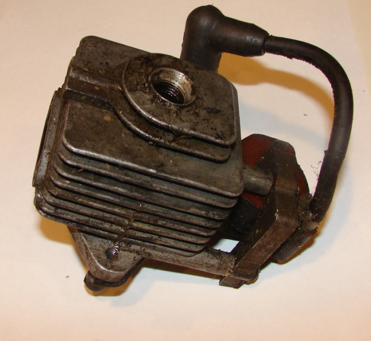

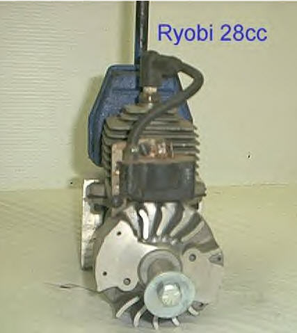

Well it's pouring rain here so with nothing much else to do I went to the barn and took a couple pictures of the 28cc cylinder for you. They are completely interchangeable with the 31's as are their crankcases. The one piece crankcase is a much later version and only 31cc engines were made at that time. The earlier style crankcase's are stepped towards the front and take a slightly different and smaller dia. reed housing and back plate. Also the crank itself has a slightly smaller counterweight dia. as the inside of the case is more compact than the next version. Next comes the unstepped crankcase with the later style reed houseing/back plate. It has a little larger inside dia. and it's crank won't go into the stepped case but it's piston and rod will, though the earlier piston cannot be used on this crank as the notch in the skirt isn't quite large enough. The 3rd. version of this engine comes with a one piece crankcase and flywheel housing and it's internals are the same as the second. How's that for a rainy day lesson? Now don't get me started on the Stihl FS 36 and 44's which are also Ryobi's but with some other changes........Images too come as I try and get a bit smarter......Bob

Well, hopefully Here They Are..........

Yep - that looks just like my 28cc.
