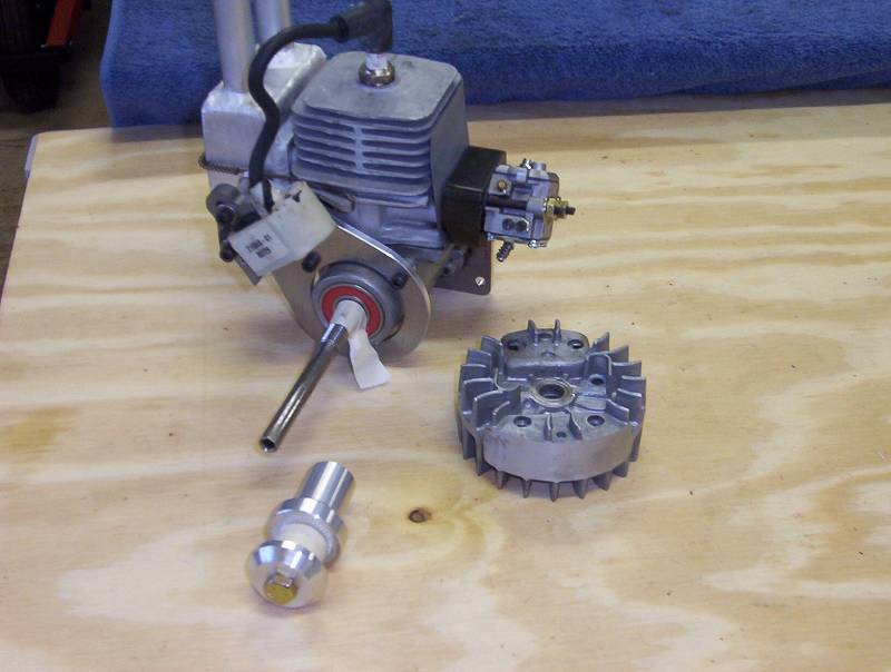

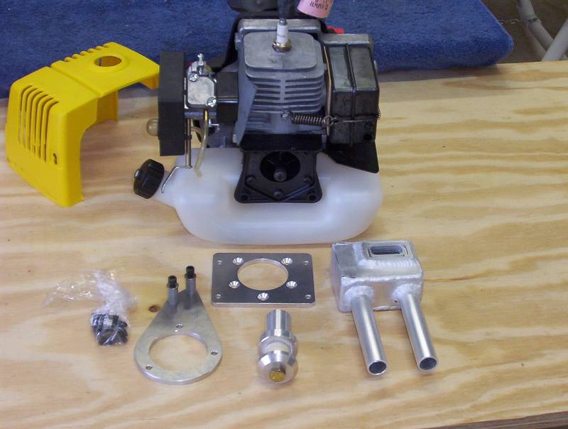

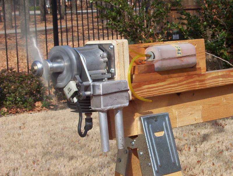

I went the expensive route (?) and bought conversion parts from Carr Precision in Oregon - about $65. A friend, with a lathe milled down the fins on the flywheel. The muffler came from Ken Lambert.

Jim Dines: I like the way your engine came out. That sure is a good way to mount mag coil. The exhaust looks nice too!. Capt,n

All the conversion stuff on my 32's came from C-H in Wyoming. Everything fit right up. Even the timing was a no brainer. There was only one way for the hall effect sensor bracket to attach and the hub was keyed.
Like Jim Dines's 32, they look like they were made to be model airplane engines.

Sorry my post was so incomplete. Mine is a 28cc. Initial runn was on APC 16X8. Here is more complete info:
http: http://www.rcuniverse.com/forum/m_38...tm.htm#3855475
