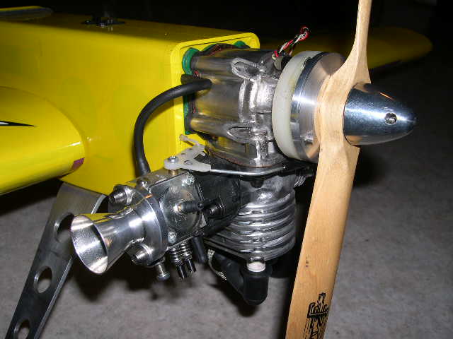

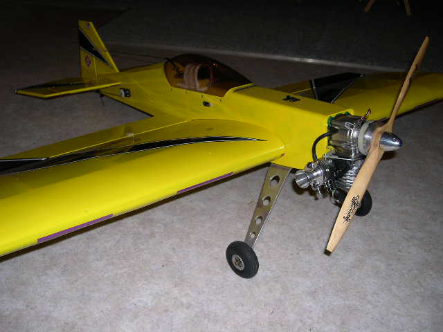

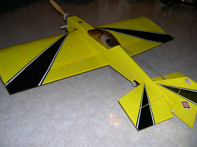

Featherlites RULE. .40 size Twist with 21cc Featherlite. All the porting mods but stock ring. Best way to reduce weight? Don't use a heavy prop hub. Just have the thrust washer fit the taper, put on prop, prop nut on crankshaft....same prop drive as glo engines. Throttle coupled spark advance. I've gathered up a bunch of these, older style, bolts better to firewall.
Also no backplate. Just run bolts from rear of firewall through rear cover and into engine. Got one for my H9 Camel, Great Plane Tripe and my Great Planes 80 inch Cub. SWEET.

Wrong pic, here's a cloer shot

Joe, That installation is beautiful!
So you took a chunk of thickwall aluminum tubing, turned it down to a washer and cut the taper????
Or were you fortunate enough to find something that worked?
I'm looking at gas-glow to shave as much weight as possible and I really like your idea.
BTW, what prop are you running on that 3D beastie?

Hello Team Monkey, 15 x 6 Zinger prop. The thrust washer/pulse wheel (holds the magnet) is made fron 1/4 inch aluminum. The prop nut is a DuBro 5/16 x 28 hobby shop item. I turned the front of the case for the pick-up wheel (holds the pulse switch for the ignition), and cut a groove in front of it for a snap ring to hold it on. It (pick-up wheel ) is connected to the throttle so spark timing advances with advanced throttle and retards with reduced throttle. Just like the older Brison set up. thanks for the interest, Joe Buitch
