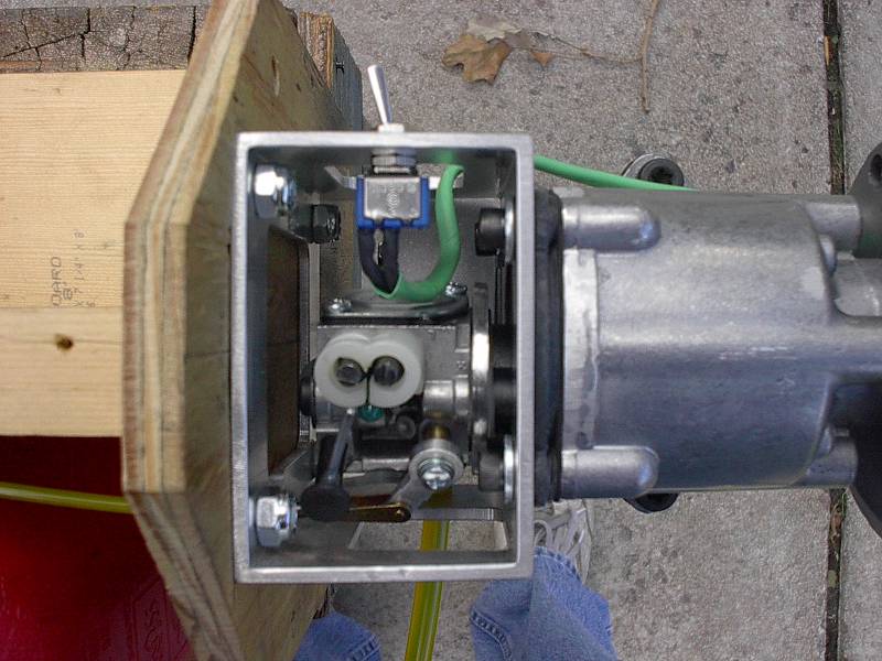

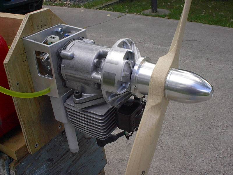

I've had good results using a Zama C1Q-M33D carb on the last few Ryobi 31cc conversions that I've done. This carburetor is reasonablly priced and can be found on *bay or I believe Scott at Brillelli carries them also. When set-up properly, this engine should produce 7000-7500 RPM with a standard Zinger 18 X 8 prop.
Just a side note, do not use a prop that allows your Ryobi to rev beyond 8000 RPM.
Hope this helps,
Capped
