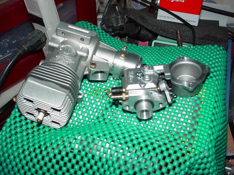

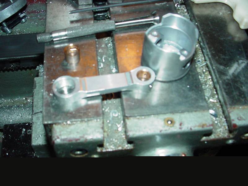

worth doing but I think machining is required, there are some videos on my site

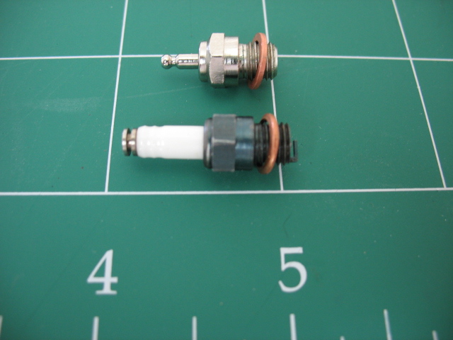

C-H sells 1/4"-28 spark plugs that they call Rim Fire for $16.95

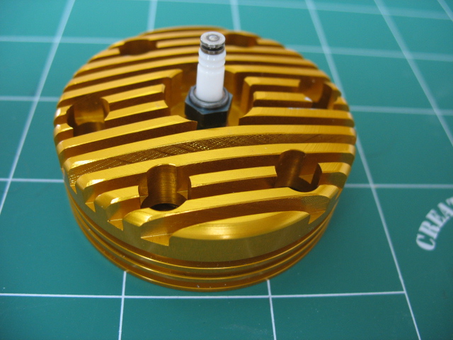

Exactlly, that is what I used in my GMS 120. Same thread size as glow plug.
