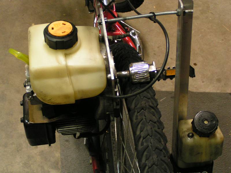

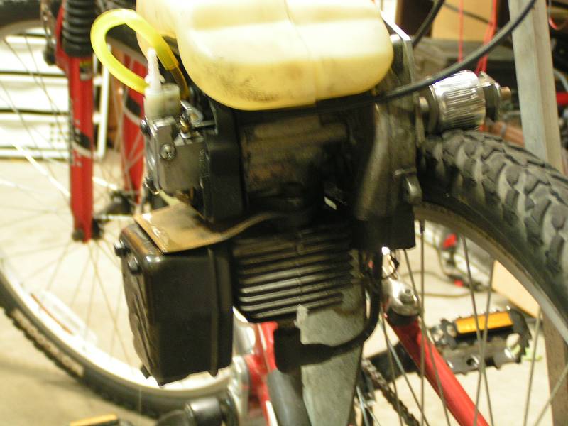

I had more success today converting another engine to biofuels, I had a Ryobi 31cc line trimmer engine I had previously converted to a bicycle motor. I converted this today to run on E85 with 4% castor. It ran better than on gas, I got smoother running, with slightly more power and speed, and the only change I made was to open the main needle about 1 turn. I'll tell you this, the E85 is close enough in energy to gasoline that the gasoline carb could be used successfully with just a needle setting change. As we know this is not the case for glow fuel. The ethanol has higher energy content than methanol, and the 15% gas has higher energy content than methanol, and with no nitro at all, which adds power but really requires a lot of volume and increased fuel flow capabilities. What's really nice is that the E85 with castor smells a lot nicer. The bike motor gives a level speed of 25mph. It's a great help uphill, very little effort is required even on like 7% grades. It's a very crude conversion, the motor is on the tire full time, if I come to stop I have to be in low gear to restart it but it only takes about 20 feet of movement to restart. I want to do one with a clutch, and a chain drive to the front sprocket which will be converted to freewheeling so I can use the rear gears to multiply the torque of the engine with the option to pedal.

You know what Jim, you're right, mine IS a Ryobi 31cc. I did the conversion to bike motor about four months ago and forgot that I got that motor from my neighbor's yard sale. The flex drive was broken so he sold it for $3. The engine runs much smoother on E85, especially at very low rpm's. It used to kick and buck a lot at the slowest speeds, but with the high octane rating of 105, that E85 fires better. I did a conversion on a Homelite 25cc a while back, it actually ran better on the bicycle downhill because it has no reed valve, the homie was piston ported. But the Ryobi 31 has more torque at low end, better for hills and larger props.
