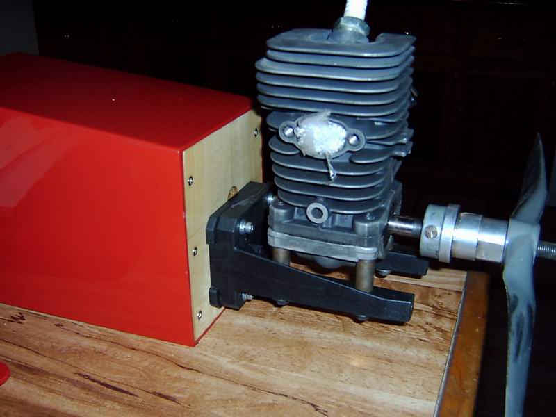

I have a Poulan 42cc on my Giant Big Stik. It pulls it straight up after about a 20' take off roll. I believe the plane weighs about 13.5 lbs.
I think the 40cc is of the same design as I also have a Poulan 36cc that looks identical to my 42cc. If it is like mine, it is very easy to convert, but you will need to either put electronic ignition on it, or use it as Gas/Glow like I did mine. The ignition parts are in the saw body; not mounted to the engine. One thing I do like about it is that unlike the commonly converted 46cc model, you don't have to make some sort of a carburetor mount. The carb mounts on a phenolic spacer like most engines.
The pics shows how I mounted mine and I have had no problems with it after a year of flying, but it is more common to make aluminum side plates that bolt to the crankcase bolts, and then bolt to a standard beam mount.

Hi,
The cheapest way would be to make your own prop hub, and gut the stock muffler and add two large outlets like I did. However, the answer is yes, CH Ignitions does make kits to convert them.
Here's a link: http://www.ch-ignitions.com/newstuff.html
Note that the 33cc stuff works on the 40, and you don't need the carb adapter shown for the 46cc engine. It would be best to call Terry at CH with your needs. They now have a cheaper ignition system available too.
As far as the carb, I'm running one with a 13.5 mm venturi. Your stock one will probably work fine. The chain saw engines don't tend to be undercarbureted like the smaller string trimmer engines.

I've got my engine on the test bench and running on the glow plug. i'm running it on 1 part nitro 2 parts gasoline. with a 20x6 prop i was getting 6900rpm. Which was pretty good, it is just over 20lbs of the thrust but only about 40mph, is that enough speed or should i look for a different prop. also i switched out the zama carb for a walbro 38B carb off of a stihl weed wacker, for ease of tuning and it did make it alot easier to get running and keep running.
The engine ran all the tests and idle without any glow plug driver. I am still amazed how easy it was to convert.

A lot of guys prefer the larger prop and lower rpms. More static thrust and less speed. I don't fly 3D however, and prefer more speed. I also like the ability to cruise around at half throttle, with power in reserve when I do maneuvers. I used an APC 18 x 8 on mine, and the 42cc turned it at around 8400 rpms. I flew the engine for a year in this manner, so it shouldn't be a problem. If you are going to put the engine in something sleek and fast like a warbird, the engine would easily pull an 18 x 10 prop.

Hi,
I was running it on Gas/Glow, and I had a Walbro carb on it. I have had some troubles with Zama carbs not "liking" the Gas/Glow mix, and distorting diaphragms. Never had that problem with numerous Walbro carbs. No, mine did not have that extra intake.
The engine worked great, and the only reason I took it off the airplane is because I wanted to try out my new twin. (Also on Gas/Glow)
