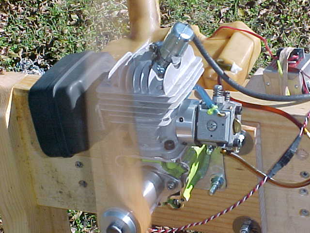

Hey Guys,
Heres a couple pics of my 42cc in process of converting.
Using CH "bolt-on" ignition....super easy.
Also made a carb adapter out of cutting board material to rotate for straight shot linkage. We'll see how the adapter holds up.
Enjoy!

Here's a shot of the Front View!
The CH conversion is TOP NOTCH quality. It works with everything from the 33cc to the 46cc.
If all goes well, I will be attaching this motor to the front of my H9 Edge.

How about some CLOSE UP shots of CARB MOUNTING on the 46cc motors....I've seen a few... wouldn't mind seeing more though!!!

Compared to weed eater motors ANY chainsaw will outperform a weed whacker conversion. Different porting and designed to run all out max rpms, where weedies are governed a bit in different ways.
Your 38cc would be fine on any 1.20 size plane...look for over 1000 sqin of wing area.
Keep in mind the 33-42cc poulans do not have the mag attached to the motor itself. They are attached to the CASE of the SAW. You'll need to get an ignition for them. The 46cc has the mag bolted to the motor but has carb mounting issues (not too much work to make a mounting method). So it's kind of a double edged sword.
