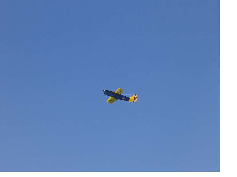

Yes, a friend of mine has converted two of these engines. One is for him and one for me. He milled off the flywheel housing flush with the crankcase about even with the front of the cylinder head cooling fins. We are using C&H ignitions for the planes they are going in so it leaves a nice round section right behind the prop adapter to clamp the pickup to. Kind looks like a big glow engine or a 3W when done. Suppose you could put the stcok ignition back on after doing the milling if you don't want the cost of the C&H. In my opinion the new two ring engines performance far outweighs any work required for getting rid of the housing. It's well worth it. I bought a yardman trimmer about a year ago that had the two ring piston but the old bolt on housing, so apparently there was a period of transition. I would imagine if one looked around they might find one of these transitional trimmers. I paid $79.99 for it. It is currently turning a 18x8 MA wood prop at 7200 rpm on a Hangar 9 PT-19 at 14.5 lbs. Flies it very well at our field which is 5200' in elevation.
