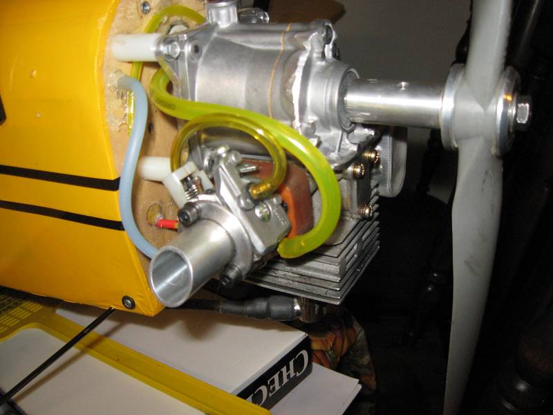

One thing i did notice is 2 breather vents on the crank. Do i need to plug those? Also the carb has 2 inlets for fuel line?

ORIGINAL: Druff1
It you probably be better if you used an external pulse for the Carb.
They work better and you won't have to worry about the pulse hole manifold for the Carb.
Then just block off the other one.
You probably had a bulb on your saw; the other "inlet" is a fuel return line.
The big fat yellow line is fuel in
Amber line is the pulse line. It simply runs into the manifold between the Carb. and the engine.
The blue line hooks to the bellows on the other side of the Carb, and goes into the dead air space.
This is so that air rushing by will not affect the Carb.
