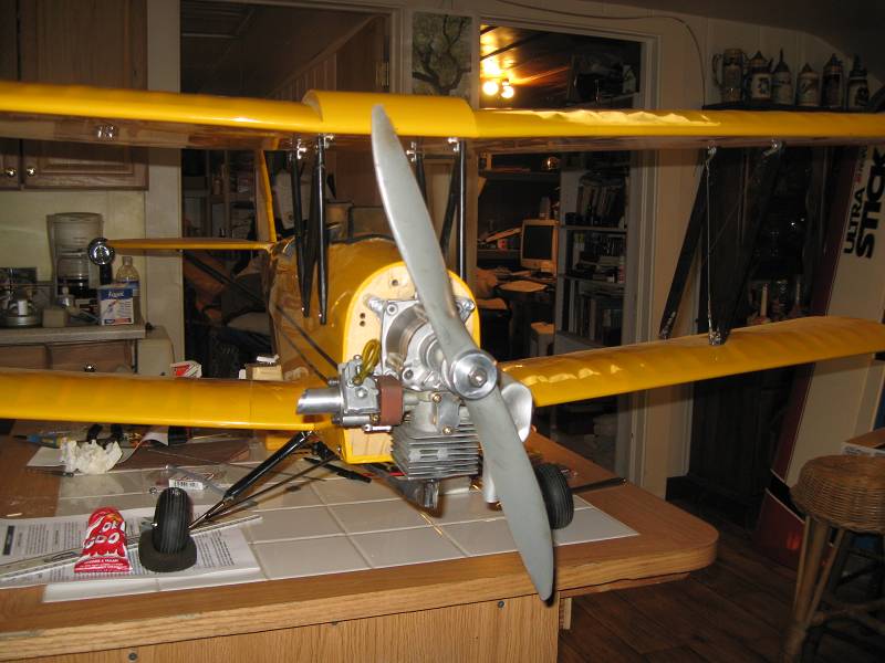

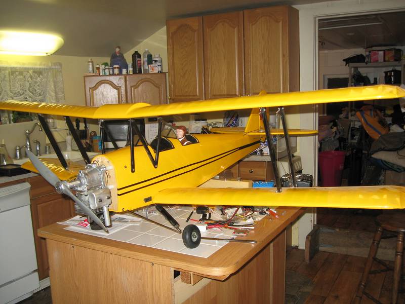

I have a 25cc Toro on mine.
According to a post I just found it weighs 3 pounds 7 ounces
and balances with no added weight, I just checked.
The battery and reciever are in back of the servo tray.
I made an access door behind the engine on the bottom of the fuse. so I
could install all of the EI stuff.
I havent flown it with the Toro yet but it balances the same as when it had a 100 Saito and balast.
Hopes this helps.

Wow Ralph. That looks like a good installation. I was worried that one of the side carb side muffler engines would be too wide. I have a Homelite 25 in a box ready for conversion. How much if any does your engine stick out the side of the cowl. I also have a Ryobi ready to go into an airplane now. What do you think about the Ryobi for this application?

1/4 inch of the muffler sticks out and 1/2 inch of the carb. excluding the V stank.
The nose of the plane is tapered or else it would be a much better fit.
Weight will be your biggest concern.
The Ryobi is narrow, but I believe the Homelite is lighter.
There is plenty of lift on this bird so it may not matter all that much
I think it looks pretty good with out the cowl.
But there are those who think it must all fit perfectly.
Some where I posted a picture of the plumbing on the engine, did you see it?
I could not find it on my computer.
Maybe I'll stop working on my Mr. Mulligan and go fly this afternoon.
Crash pictures soon to follow. I hate maiden flights.

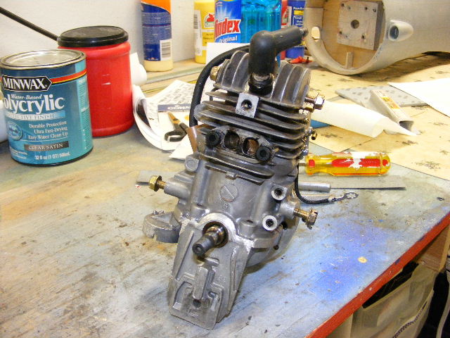

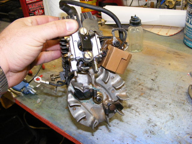

Here are some pics of the Mcculloch 34.4cc stripped down and cleaned.

Ya know, I had one of those. I figured the carb was going to end up too close to the prop, so I gave it to my brother to use for parts.
It will be interesting to see how it works for you.

I was looking at that too.
But I couldn't tell how close the Carb. was.
Perhaps EI and run it backwards with the carb in back.

Possible, assuming the muffler wouldn't block enough cooling air to be a problem. Perhaps just a header pipe running back to a canister muffler.

The carb sticks out just a little past the flywheel. I think it would be ok with a prop hub on it.
