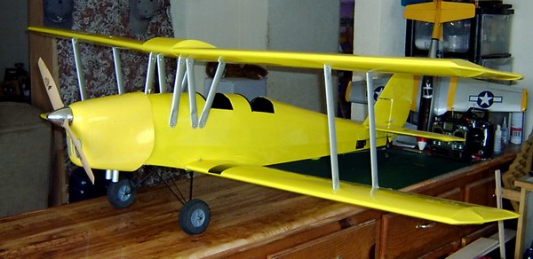

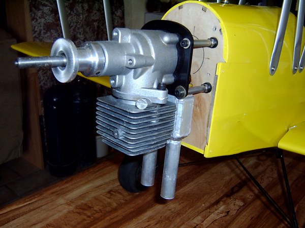

Here's some pics of mine as I was building it. 78" wingspan. It's from Nitro Planes. Ryobi 31cc on Gas/Glow.
It's got lots of lift! It surprised me on the test flight by levitating off the ground before I got past 1/4 throttle into a slight breeze.
I always liked the "lines" of this airplane. Definitely a classic.
AV8TOR
