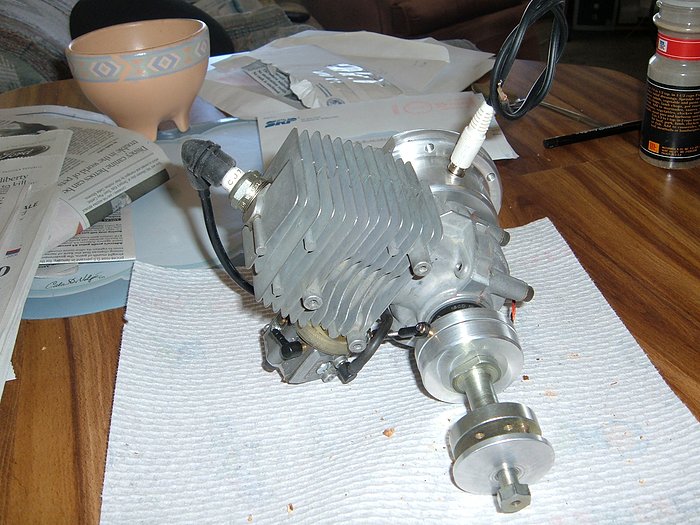

Old 03-17-2008 | 08:26 AM
mrbigg's Avatar
My Feedback: (21)
Joined: Oct 2004
Posts: 4,832
From: Streator, IL
Default RE: Lightweight Gas Conversion?
Here's a pic of a G38 that Ralph did. I found in an ad here. I'm going to test the 38 on a pipe here soon. Just give me a week or so.
