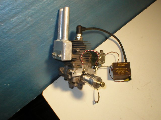

Heres a pic of my 28cc stihl[27.2] actual.Nice thing about it i can rail mount it or flush mount it stock as the way it came out of trimmer.Right now i have a WA200 on it wich has an 11.13 venturi.Im running an APC17x8 and im getting around 7400 rpms.Its basicly running like my OS160 did before i sold it [the apc prop came off of the 160].Weighs 3-1/2 lbs RTF with prop and[ch] ign.[without battery].Im putting mine in a scratch built cap 232,ws73",should weigh about 9-10 lbs at a guess.Wing loading will be about 24ozs square foot.

The muffler was made by:
www.lambertsrc.com
The timing ring that holds the cdi magnet an hub i made myself after i bought my lathe.The timing ring i call it i used a hole saw and cut the middle out of the flywheel and then dressed it up with my lathe and then the hub just screws on.On yours if ya wanted to keep the stock ign ya would just cut the fins flush with flywheel and screw the hub on.Using a cdi makes starting a breeze,ya also get better timing and a little boost in rpms but you only loose about 8 oz average so ya dont loose a lot of weight.You could also gut your stock muffler and put a straight pipe on it.Check in this forum for mufflers,especially by av8tor,he makes his own and ya cant beat em.I just bought a G23 carb adaptor for my toro and it works perfect.ill have to check and see if it works on stihls.Otherwise i would make or modify my own.

I just checked both my stihl engines and the mufflers off of a G23-26 from horizon hobby will bolt up with no problem.I just tried a carb rotator from horizon and it doesnt fit.Most of us make our own out of G10 board or epoxy board.This turns the carb for a straight shot to the servo.Tim could make all your items and or do the work[ive seen it].I checked my ch catalog and it doesnt mention anything about stihls but its an older catalog.I chat and trade back and forth from Ralph and hes definatly the man but you said cheap.I have a hub already made up here also.Identical to the one in my pic.Im doing the 25.9,somone said it was more powerful because its off the pro series version.

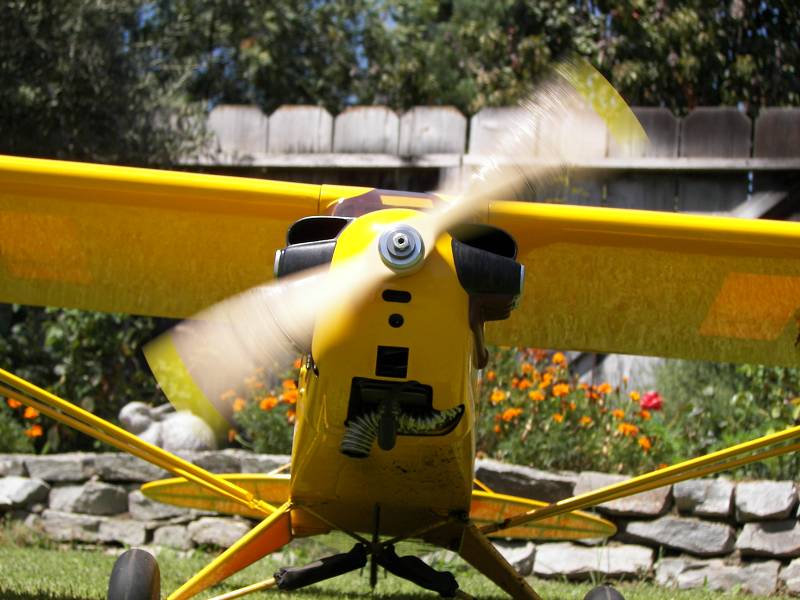

Hey guy's,here are some pictures of my conversion.I know it's been awhile but I'm just learning how to post pictures.Enjoy!
Jim
