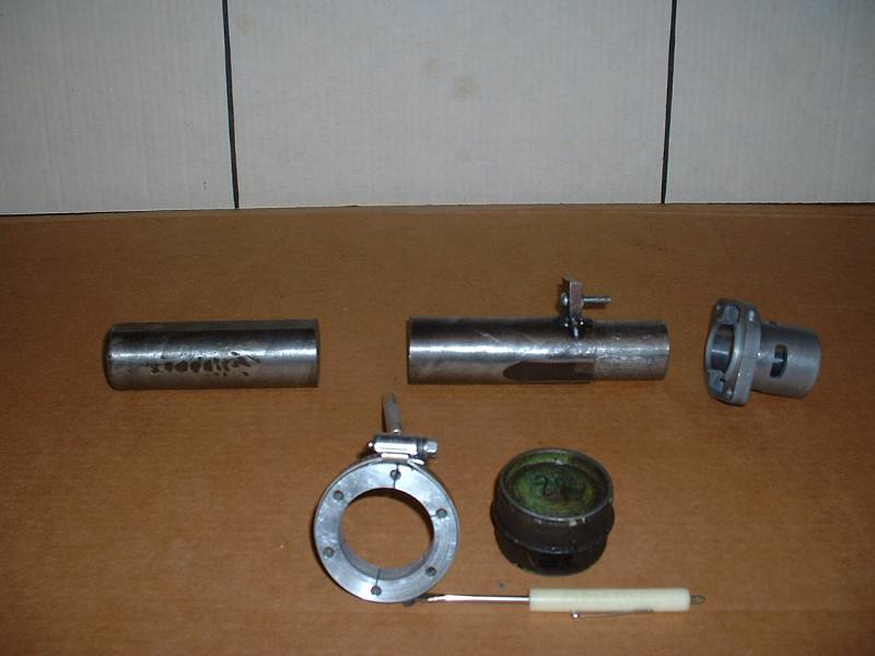

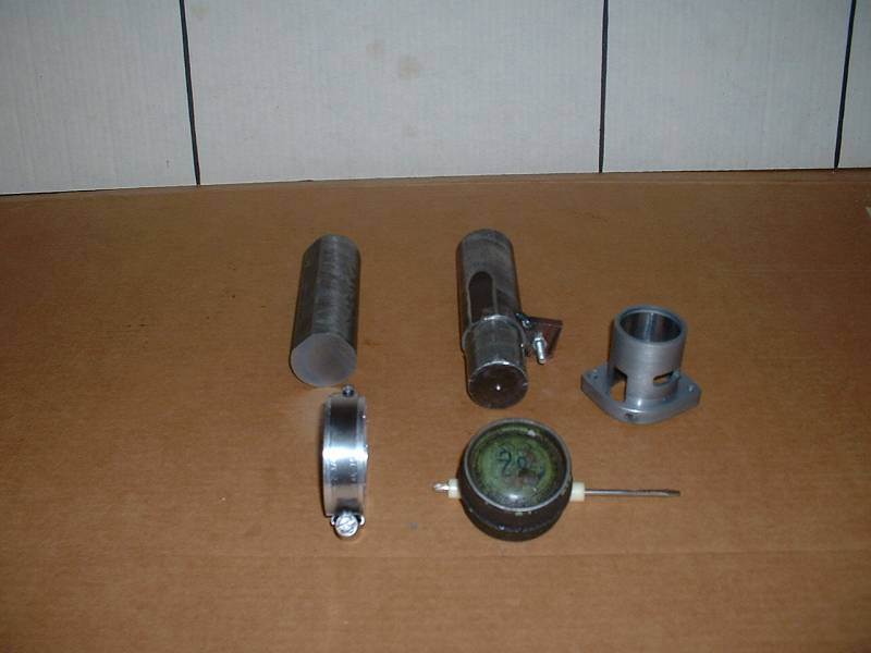

I have an Echo cylinder with the fins turned off.
The OD T.I.R is within .0005” which is just peachy.
The trouble, is that I’ve managed to turn a taper of
About .0025” within a space of 1.570”.(mandrel to cyl.fit too loose)
The amount of stock I left to play with is only ~.010”
Maybe a tad more,What are my options…?

T.I.R = Total indicated runout as was checked on the outside
diameter of the cylinder.
The mandrel is in the photo below.
The mandrel diameter was turned to allow one wrap or mylar tape
around the area where the inside of the cylinder fits for protection
I should have split the mandrel for adjustment.
The taper is on the "x" axis. (left to right as pictured.)
A four jaw chuck was used to hold and the job.

OK, I got your problem:
Runout concentricity to cylinder bore realy is not critical, but removing a slight amount of metal to get the fit to the cooling jacket just right is important.
Here is what I would do:
Fit the mandrel in the 4-jaw.
Make strips of newspaper-paper, about 1/2" wide, and paste these to the madrel with a bit of grease. This paper is 0.002" thick, and should do well to get the right friction fit between mandrel and cylinder.
When satisfied, tap the cylinder on all the way and adjust the runout with the 4-jaw. If you want to be very precise, also check runout on the mounting flange to be sure the cylinder bore is wobble-free. I do however not think that is critical, because the bore should be perpendicular to that mounting face if your cylinder is OK to start with. Whichever way you fit that cooling jacket will not change a thing to bore-flange alignment.
On each check station, also check lengthwise integrity (straightness), so you will have no wobble. Tap- and adjust the mandrel in the jaws until you are satisfied with straightness and runout of the cylinder. When done, you should be within 0.002 T.I.R on all possible sections.
I did a similar thing in a 3-jaw. It took me quite a while. A 4-jaw is much easier to adjust.
The cooling jacket need not be a press fit. A smooth tight slide fit will do (thump pressure fit). The cylinder in operation heats up and expands right onto the cooling surface, as is the case in our glow engines.

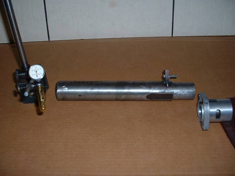

I found that by trying not to cut the mandrel length (to save the stock for another use) That the runout was being exaggerated... I cut it in half, and will split the end next to the drive dog for a small wedge to hold the cylinder snug,but not heavily forced to the mandrel.
I read up on the theory of external lapps and made one. I made it .001" undersize before splitting and segmenting.
I gave it a test on the part,but I probably should take care of most of the.0025 taper first.
The little can in the picture holds two grits of lapping compound.

The taper problem turned out to be a substantial twist in the 36” bed on my
old Atlas lathe. The cabinet/bench was not stout enough to resist any attempt
At counter twisting with shims,so I made up a stout top from “c” channel
Notched and welded it in place. Leveled it in, and the twist came right out.
Just something to check if your lathe is turning an unwanted taper.
