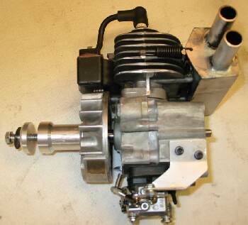

I built a muffler for the same motor
I can send you more pics and info if you like
Don [email protected]

Kraker, your muffler is very typical of a muffler on a gas engine. It was nice of you to utilize the existing spring retainers too.
Good job,
Jim
