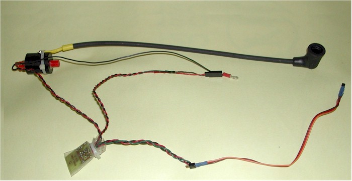

I just put together one of Jerry Howell's kits, the one mentioned in this thread, It is working fine, You just have to obtain the spark plug wire and the plugs and wiring for the sensor and battery. The timing is fixed.

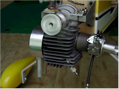

Here are pictures of Jerry Howell ignition and Homelite 45 conversion.

Can't seem to get but one attachment at a time.
Here is the Ignition.
Jim
